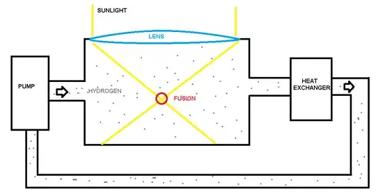

The point of the diagram below is to create a focused point of light at a point in space that is far from the walls of the chamber and is hot enough to fuse a fuel material. The fused material is very hot at the point of fusion but cools as it mixes with the other unfused fuel. Hopefully enough mixing occurs so that the temperature at the walls of the chamber and piping is low enough to avoid melting them.
The fuel material is actively circulated by a pump to a heat exchanger. Most of the material circulates in a loop, but obviously fused material needs to be removed at some point, and new fuel added.
I used hydrogen in my diagram, but I will accept answers that use another fuel material if its more suitable.

No. The hottest temperature you could achieve by focusing sunlight is the temperature of the surface of the sun*. That is a few thousand K, whereas fusion requires temperatures in the millions of K.
*heat flows from a hotter object to a cooler object. So if the focal point ever became hotter than the surface of the sun, then heat would flow from the focal point to the sun.

No.
Consider looking through the lense (DON'T DO it with the SUN, of course. THINK about it.). The Sun looks bigger. In this sense, the lens "brings the Sun closer to you". Importantly, the Sun's surface looks no brighter. (A safe way to convince yourself of this is to remember how it works when looking at ordinary objects. They get larger, but they don't get brighter.)
The best possible lense will be so big and so magnifying that it will make the Sun look so close that it fills the entire half of your vision. Being under this lense would be being like sitting on the surface of the Sun. You will be getting a Sun-bright surface right up against you.
Your eyes will detonate instantly and you will be rapidly incinerated, at 5800 degrees absolute, but hydrogen will not fuse. Much like a poor ant (please don't torture ants though either :) ). The poor ant dies because it "sees" a Sun that fills a very big part of its field of view, as though it were transported to the Earth 4 billion years in the future near the end of the Sun's lifetime.
That is the limit. To get any hotter, the surface brightness would have to go up. The only way to arrange for that is to add energy actively, and passive optics can't do that.
