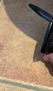

In a well-lit room, a light source shines light on the objects in the room, some of which reflects back off the objects. We can make the light source brighter by causing it to emit more photons, which means more photons are hitting the objects and also reflecting off the objects and thus they appear brighter as well.
Therefore it seems that if I place a mirror in the room that reflects the light coming off of an object back to it, the object should get brighter, because more photons are now hitting it than there were before. But when I physically do this, the object doesn't get brighter.
This holds true even if I place the mirror on a part of the room that was shadier than the object, to eliminate a possible effect that the object is simply getting less light from the direction of the mirror than it was before:
(higher-res versions: one two)
The floor is equally bright on the area that the mirror is reflecting the floor's light back at it and the area where it isn't.
Shouldn't the floor be brighter with more photons on it than before?

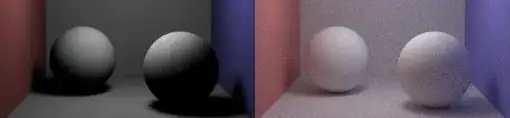

For example, here's one thing that's a consequence of light bouncing around that you probably didn't think of, that can be observed in your images. For those points on the floor that are in shadow, the direct path to the light source is blocked. That is, no light is coming to them directly from the light source. Yet, the shadows are not pitch black - why is that? Why don't shadows appear as in the first image below?
enter image description hereenter image description here
It's because these areas are illuminated by the light that's bouncing off of the walls of your room (or, if you're outside, by the bouncing in the environment, and coming from the sky). The walls are diffuse reflectors (unlike a mirror), meaning that the light bounces off of them in all directions, basically randomly.

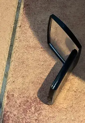

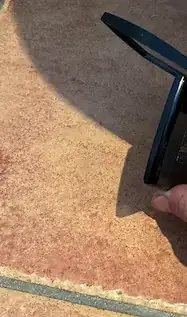

Let's look at another example - the back side of the mirror.
The casing is black, but it's also partially reflective (more like a mirror than like the walls). You can see the reflection of the floor in it - you're not seeing the dark color of the casing. The reason for this is because there's light bouncing off of the floor, and hitting the back side (and then bouncing off of the casing, and hitting your eye).
But also, take a close look at the floor itself, right next to the back side of the mirror. It's a little brighter than the floor further away. That's light bouncing off of the casing, and hitting the floor. In the image on the right, I tried to adjust the contrast so that the effect is better seen. Notice a rectangular band of light, with a dark strip in the middle - I'm guessing the dark strip is produced by some sort of writing or a label on the surface that's less reflective than the casing itself.

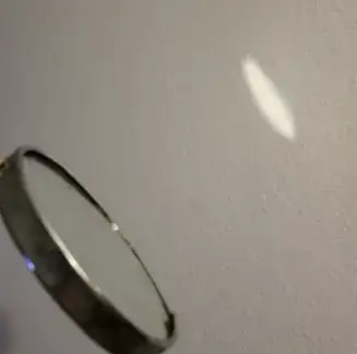

You can certainly make objects brighter by bouncing light using a mirror. It looks like this:
You get a sharply delineated bright area.

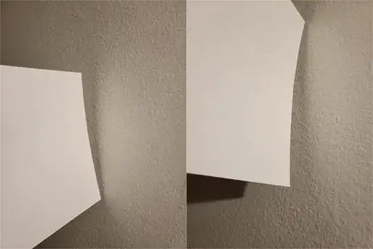

Instead of a mirror, take a white sheet of paper, and place it against one of the walls, so that the surface of the paper faces the light. Try to do it relatively close to a bright light source. It's better if you can arrange things so that there's only one source of light in the room (so, turn off computer monitors, TV sets, etc.)
In the image above, notice that the darker area between the paper and the brightened area is not the shadow of the paper - that's just the brightness of the wall without the paper present. You can see the shadow way behind there.

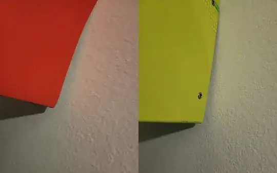

Or, take something colored, and observe how the light it bounces takes on the color of the object (that's why the object appears to us to be colored that way in the first place - it only reflects certain wavelengths of light - only certain parts of the rainbow):

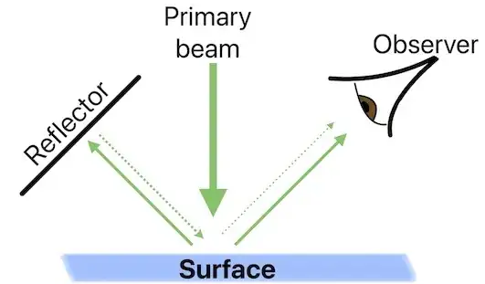

Recycling light
As noted by Kirk McDonald in "Intensity, Brightness and Étendue of an Aperture Lamp"
while brightness is invariant during optical transport, the initial brightness can be increased by the “trick” of “recycling” light back onto the initial emitting surface such that each emitted photon contributes many times to the photometric measure of brightness.
The use of this "trick" to increase brightness is also discussed in "Beating the brightness theorem: thermodynamics of light recycling (experimental)" by Fu, Leutz, and Reis. (This article is, unfortunately, paywalled, but most of its content can be found in Fu's unpaywalled PhD thesis on "Increasing the Brightness of Light Sources".) The same authors note that "Light recycling contributes to brightness in filament lamps" and that light can be recycled in solid state devices without violating the Second Law of Thermodynamics.
Some points about light recycling:
  • Brightness (perceived optical power emitted per unit solid angle per unit area) of a surface can be increased while conserving étendue if some of the reflected light scattered from the source is superimposed on the same phase space (étendue) as the original light emitted by the source.
  • The currently accepted answer gets close to this in the paragraph near the end when it notes that "specular reflection would continue to have the same etendue as the light from the light source". A crucial point is that even though diffuse reflection is spread over more phase space, a small part of it will also overlap with the same etendue as the light from the light source.
  • Total radiated power is not increased since although the source is brighter, light is only radiated over a smaller area and solid angle because of the mirror's shadow.
  • The Second Law of Thermodynamics is not an issue because energy (in the form of light from the primary light source) is being continuously supplied. This is similar to how although the Second Law means that surrounding an inert hot rock with a reflective sphere cannot increase its temperature but only slow down its cooling, surrounding an incandescent bulb star with reflective sphere would increase the bulbs temperature and brightness. Total entropy - including that of the bulb's power supply - does increase, but the optical entropy does not have to. A fun extreme example of this is how a reflective Dyson sphere would cause the star to heat up, e.g. See "Evolutionary and Observational Consequences of Dyson Sphere Feedback" or "What would happen to a star if most of its energy were reflected back at it?".
  • In this question, the brightness of the object cannot exceed that of the primary external light source (e.g. the Sun or the room lights) because light is not being reflected back onto that primary source. The brightness of the object can, however, increase because we are reflecting light back onto the object.
  • Although the increase in brightness is tiny in the situation described in this question, a significant increase in brightness is possible with other sources and optics, e.g. see Eq. 2.23 of Fu's thesis or this paper on "High-directional light source using photon recycling with a retro-reflective Dome".

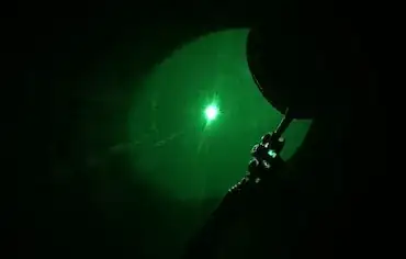

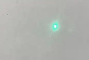

Laser pointer demonstration
An easy experiment that makes it obvious that reflected light can increase surface brightness is to point a laser pointer at a diffuse reflective surface. Without a mirror, one sees just a single bright spot (with a few artifacts because of the laser pointer and phone camera optics).
Laser spot on light coloured surface
If one uses a mirror to reflect the diffusely scattered light from the laser spot back onto the surface around the laser spot, in room light it is hard to see much:
Laser spot on paper reflected back on paper
In a dark room, however, one easily sees the reflected light over a large area.
Laser spot on paper reflected back on paper in a dark room
The brightness of a large area - including the laser spot - has been increased.
I used a 3 cm in diameter mirror about $d\sim 3$ cm from the $r\sim1$ mm radius laser spot, so we expect the order-of-magnitude of the reflected light to be not more than about $r^2/d^2\sim 10^{-3}$ of the laser brightness. In a dark room it is easy to see the one-thousandth less bright reflected light surrounding the spot, and the same amount of reflected light must be coming from the laser spot, so its brightness must have increased by (an impossible to see directly) factor of $\sim 10^{-3}$.
