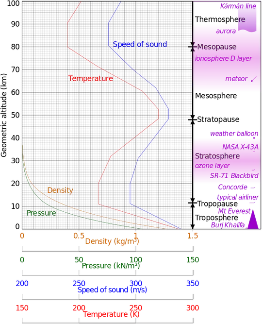

The below image from https://en.wikipedia.org/wiki/File:Comparison_US_standard_atmosphere_1962.svg shows the broad range of temperatures/pressures of Earth's atmosphere.
image courtesy of Wikimedia user User:Cmglee

The reference sound intensity, $I_{o}$, depends upon the characteristic acoustic impedance, $z_{o}$, as $I_{o} = P_{o}^{2}/z_{o}$. We know that $z_{o} = \rho \ C_{s}$, where $\rho$ is the mass density and $C_{s}$ is the speed of sound. We can model $\rho = \rho \left( h \right)$ using a known atmospheric scale height and an exponential decay (which reproduces the orange line the figure above) and take a set of values from the blue in the figure above for $C_{s}$ (see table below). Then we find that $z_{o}$ ranges from ~0.003-416 Pa s/m from 0-100 km altitude. If we use the human hearing threshold for $P_{o}$, then $I_{o}$ ranges from ~$10^{-13} - 10^{-7}$ W $m^{2}$.
