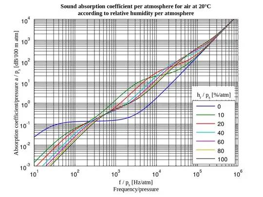

I have just learned the surprising fact that the attenuation coefficient of sound in air depends strongly on relative humidity: at any given frequency, it can be several times larger in very dry air (10-20% RH) than in very humid air. The internet suggests the reason for this is that sound travels faster in (less dense) humid air, but this does not make sense. The speed can change <1% while the attenuation coefficient changes 400%. Does anyone have a more complete explanation?

You are absolutely right that humidity plays a large role in acoustic attenuation, like the plot below shows. While you did ask for a more complete explanation, I should warn you that the physics behind this are non-trivial. I'll try to make it as easy as I can, though.
There are three mechanisms of attenuation in air. They are viscosity, thermal conduction, and molecular relaxation. At audible frequencies, molecular relaxation totally dominates. Unfortunately, this is also the mechanism that is the most tricky to explain. But by explaining it, I can also explain why humidity affects acoustic attenuation so much.

You can see where this occurs as two bumps in the above graphs of attenuation in air. The bump at the lower frequency is due to vibrational relaxation in nitrogen, and the bump at the higher frequency is due to vibrational relaxation in oxygen.
The effect of humidity
Now, finally, we can start to appreciate why humidity has such a big effect. The reason is that water molecules act as catalysts for the relaxation process. (Quantum mechanically, collisions between water molecules and nitrogen or oxygen molecules have a higher probability of knocking the latter molecules into higher or lower vibrational energy states.) Thus, the higher the humidity, the quicker the relaxation process works, and the shorter the relaxation times $\tau_N$ and $\tau_O$ become. You can see this in the above graph; as the humidity increases, the aforementioned bumps corresponding to $f \tau_N \sim 1$ and $f \tau_O \sim 1$ occur at higher frequencies, because the relaxation time is shorter.
