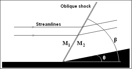

The way to reduce the sound is to reduce the pressure change across the shock, which can be done using an oblique shock.
oblique shock example
In this case, the angle between the shock surface and the incident flow speed, $\beta$, enters into the pressure ratio for a hydrodynamic shock as: $$ \frac{P_{2}}{P_{1}} = 1 + \frac{ 2 \ \gamma }{ \gamma + 1 } \left( M_{1}^{2} \ \sin^{2} \beta - 1 \right) \tag{1} $$ where the subscripts $1$ and $2$ correspond to the upstream and downstream regions, respectively, $\gamma$ is the ratio of specific heats, $M_{j}$ is the Mach number in the $j$ region, and $P_{j}$ is the average pressure in the $j$ region.
As you can see, in the limit as $\beta \rightarrow 90^{\circ}$, we approach the standard expected limit for a hydrodynamic shock. This is equivalent to looking at a shock produced by a piston/driver with a planar surface orthogonal to the incident flow.

All of this leads me to the question, is it possible to counteract, or cancel, the noise of a sonic boom?
Cancel, probably not. Reduce greatly, probably yes. One way is to change the shape of the nose cone of the jet, which alters the shock geometry (as I discussed above). For certain geometries, one can get a reduced pressure ratio (e.g., Equation 1) and thus, a smaller overpressure sound wave resulting in a "quieter" sonic boom.

The phase diagram image was taken from Wikipedia, courtesy of EMBaero - Own work, CC BY-SA 3.0, https://en.wikipedia.org/wiki/File:Obliqueshock.PNG
