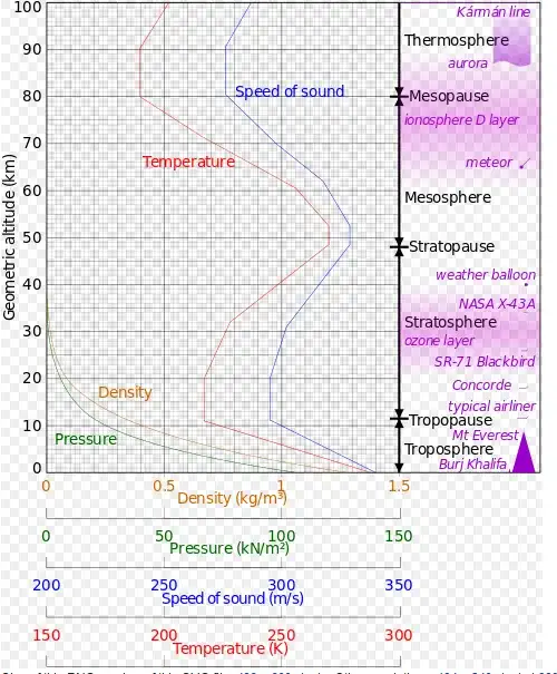

This graph is very puzzling to me. It is my understanding that the speed of sound relates to the density of the media it travels through. Sound travels faster in water, and even faster in steel. So what is the underlying reason for this relationship between speed of sound and temperature. Perhaps temperature relates to the speed the gas molecules, but I would still expect that the pressure drop and density drop should affect the speed of sound more. AFter all, don't they say you can't hear sound in space because there are too little moleucles. Thanks.

The sound speed squared is given by $(\partial p / \partial \rho)_s$ where $p$ is the pressure, $\rho$ the mass density, and $s$ the entropy. The $s$ outside the parentheses means that entropy should be held constant in taking the derivative. At a first pass, we can ignore this constraint, and just do some dimensional analysis using the ideal gas law, $pV = n R T$, where we can identify $\rho = n M/ V$ where $M$ is the mass of a gas molecule. Roughly then, $(\partial p / \partial \rho)$ is proportional to $T / M$. The density drops out. Of course, we performed this derivative at constant $T$, not constant $s$. Fixing this up will introduce a factor of $\gamma$, the adiabatic index, an order one number which depends on the structure of the gas molecule -- monatomic, diatomic, etc. The density, though, drops out of the sound speed. More details can be found here.

Consider that the speed of sound is dependent on the rate at which one molecule moves to a second molecule, impacts it, and that second molecule travels to a third molecule, etc. If you remove the molecule in the middle, so that the first molecule travels all the way to the third molecule, it doesn't change how fast that "message" was conveyed. The first molecule had to travel twice as far, but it did so just as quickly as if the middle molecule picked up the velocity and transmitted the "message" instead. Think of temperature as the speed of the molecules.
