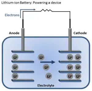

When a Lithium-ion battery discharges into a load, for instance, there is no electron flow in the battery, but there is still a current flow:
Lithium-ion battery discharging into resistor
(Source: Center for Sustainable Nanotechnology)
If you considered only the electron flow, your calculations would be wrong. You need to consider the net flow of charge, no matter what the charge carriers. Conventional current abstracts away the different charge carriers and represents all of these different flows as a net flow of (positive) charge, simplifying circuit analysis.

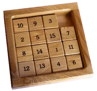

Have you ever played the sliding-15 puzzle? There are fifteen sliding pieces, numbered 1 to 15, arranged in a 4x4 grid. It has one "hole" where there is no piece. You can move any piece adjacent to the hole into that space.
Sliding-block 15 puzzle .
As you play the game, what is moving: the numbered pieces, or the hole?
Technically speaking, you are moving the numbered pieces. They are the electrons, the physical objects that move around. You can even get them to move in a complete path (a closed circuit).
But if you have played this game for enough time, you quickly realize how important the hole is to the strategy of the game. A skilled player can move the hole anywhere he wants, and the hole can even move around in a closed circuit. The hole represents the absence of electrons, and can move around just as the electrons themselves can. In semiconductor theory, we even officially call them "holes" and treat them like a particle, even though they're not.
Whichever way you count, there is something moving. In electricity, we call this "charge". Ben Franklin called it "electric fire" (see below).
Notice that whatever move you make, there are always 15 numbered pieces and 1 hole. We say that this is conservation of charge, and was discovered by Franklin (see below). As long as we are counting or adding things, it makes sense to make one kind of charge positive and another kind negative. How shall we assign which is which?

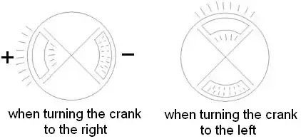

If we rotate the discs of a Wimshurst machine by turning the crank manually to the right in a dark room (the most noticeable results can be seen at night in a room with a little exterior street light entering it), and if we do this for at least 10-15 seconds to let the eyes get used to the feeble light, we will notice that the horizontal quadrants emit a light flicker, whereas the vertical are completely dark. On turning the crank to the left the flicker relocates to the vertical quadrants, whereas the horizontal ones now remain dark. Looking even more attentively at the scene, we will notice an essential qualitative difference between what happens in the left and the right quadrant (i.e. the upper and the lower one when the crank is turned to the left). The flicker in one horizontal quadrant is directed from the metal sectors outwards, in the other one inwards. In other words, in the left quadrant the metal sectors are dark and the flickering light glows around them, but in the right quadrant the metal sectors are illuminated and around them it is dark.
The metallic sectors in the image are drawn as a whole, and not individually, because the light phenomenon appears as a whole; more precisely, as two wholes, one left and one right, and not individually in the sectors.
The electricity of the left quadrant (picture on the left) is the same as the vitreous electricity; the electricity of the right quadrant is the same as the resinous electricity. I will not explain how this is determined, because this answer will become much longer (you can check it out here https://newtheories.info). So, if Benjamin Franklin has determined what is positive and negative about electricity, he did it right.
