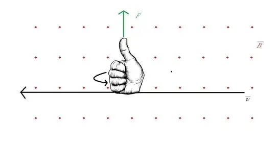

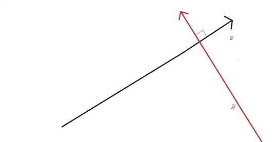

Look at the diagram below,
Two vectors $B$ (Magnetic field vector ) and $v$ ( velocity vector of a proton ) shown in the diagram are perpendicular to each other. Here, I have considered the simplest case where the two vectors are perpendicular to each other. The cross product of $B$ and $v$ gives us another vector $F$ ( Force vector ) which points in a direction perpendicular to both $B$ and $v$. This is the geometric meaning of the cross product. Say, $B$ and $v$ lie on the $x$-$y$ $plane$. The force vector obtained as a result of the cross product will point in a direction that is perpendicular to the $x$-$y$ $plane$. $F$ therefore points in a direction parallel to the $z$ $axis$. This leaves us with a question. In which direction does $F$ point? $-z$ $axis$ direction or $+z$ $axis$ direction. Using the $Right$ $Hand$ $Rule$, one can easily solve this issue.

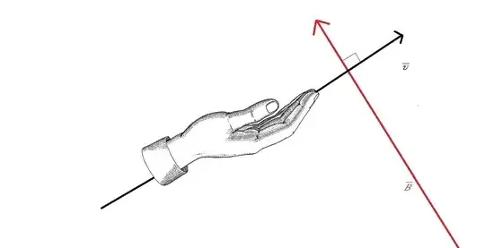

Place your right hand on $v$. Now, curl your fingers in the direction of $B$.
Here, $B$ is considered to be coming out of the screen. As you curl your fingers, you see that they are also coming out of the screen( in the direction of $B$ ). The thumb points in the direction of $F$. If $B$ were considered to be going into the page, $F$ would have pointed downwards.
Remember, I worked with a proton. If one works with an electron, one has to flip the direction of the force due to its opposite nature.
