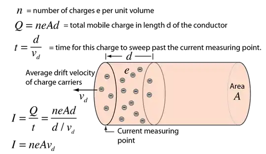

This link may help:
Since electric charge is quantized in discrete multiples of the electron charge, it is instructive to look at electric current as the movement of multiple microscopic charge carriers with a drift velocity in a conductor.
current
If current is ACTUALLY electrons moving, then how does is it different from electron flow?
Using the calculator in the link:
drift
The drift velocity of the electrons is low. The transport of energy though of the collective motion, is due to one electron pushing with the electromagnetic interaction the neighbor. This energy goes close to the velocity of light. So the collective effect, the current, is different than the individual electrons' motion, in this example of a current in a conductor.
There are different forms of charge carriers as explained in the other answers.
