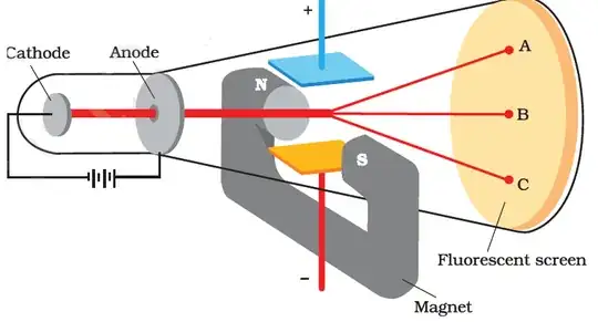

My question is regarding the direction in which cathode rays bend in a magnetic field.
My book states that :
When only electric field is applied, the electrons deviate from their path and hit the cathode ray tube at point A. Similarly when only magnetic field is applied , the electron strikes the cathode ray tube at point C.enter image description here

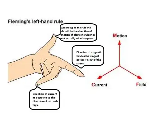

I tried to apply the Fleming's Left hand rule used to find the direction of force on a current carrying wire where the direction of current is taken opposite to the direction of flow of electrons.
The Fleming's Left hand rule states that :
Stretch the thumb, forefinger and middle finger of your left hand such that they are mutually perpendicular. If the first finger points in the direction of magnetic field and the second finger in the direction of current, then the thumb will point in the direction of motion or the force acting on the conductor.
Applying this rule I found that the electrons should hit the cathode ray tube at A in a magnetic field . But in the book it is given that they strike it at C.
Edit : I am adding a picture which makes it clear how I applied the rule. enter image description here Please explain me where I went wrong . Thank you.

You're right, and your book is wrong. The magnetic field is coming out of the page. The velocity vector of the electrons is to the right. The magnetic force acting on the electrons is $-e\textbf{v}\times\textbf{B}$, which is up. The is contrary to the information stated in the quote in the book. The deflection should be up.
The rule applied is correct but because electron is negatively charged your actual answer will be exactly opposite of what you would get. The answer that you got is correct for a positively charged particle.

Book is right because it says the magnetic field is in inward direction.so, while pointing your index finger inward,the thumb faces down.
Ritika

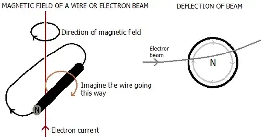

I believe the force by Fleming rule is correct for POSITIVE charges, while electrons are negative and suffer force in opposite direction.
So, direction of current opposite than electrons movement; and magnetic force on electron opposite than Fleming rule.!
otherwise we can use the left hand with opposite direction, like in photo ;)

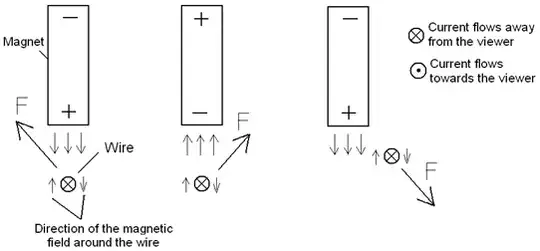

Before we present our explanation of this phenomenon, let us consider a few more experiments. We place a stiff copper wire on a table. Parts of its length don’t touch the table. Above a wire section that does not touch the table we hold a strong cylindrical magnet with its positive pole down, so that the wire lies exactly under the middle of the magnet. Then we connect a new battery to the ends of the wire so that the positive pole is closer to us and the negative pole further away from us. At the moment of connection we will notice that the wire makes a strong deflection to the left and up. As soon as we turn the magnet over and repeat the same, the wire will make a strong deflection to the right and up. If we hold the magnet again with the positive pole down, now not directly over the wire, but left over it, however still close to it, we will notice that the wire after connecting to the battery makes a jerky movement to the right and down. How is this explained? In the first variant, the permanent magnet “blows” down; the magnetic wind in and around the wire blows clockwise spirally from the plus to the minus pole of the battery; it blows down on the right of the wire, up on the left of it; on the right of the wire both magnetic winds coincide (the effect intensifies), and on the left of the wire they collide (the effect weakens); the wire moves to where the effect only intensifies, namely to the maximum, and that is to the left and up. In the third variant, in which both winds only collide, the wire deflects to where the adverse effect is maximally attenuated or quite ceased, namely to the right and down.
