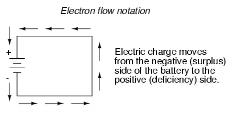

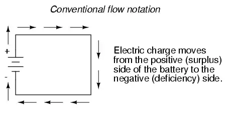

Once a convention is fixed for the electric charge, a natural convention emerges for the sign of the current, voltage, and many other electric observables, too. It just happens that in the circuits, the arrows for the current have the opposite direction than the velocities of the electrons but this discrepancy only became visible once people knew that the currents was composed of the negatively charged electrons which was a long time – a century – after Benjamin Franklin's setting of the convention. This apparent discrepancy causes no problems as long as we carefully follow it and realize (and, when necessary, emphasize) that the arrows represent the current according to the established conventions and not the electrons' velocity.
One should also point out that there exist conductors where the conductivity is guaranteed by positively charged carriers (or both), for example in solutions (positively charged ions) or semiconductors (holes). In those conductors, the signs of the current agree with the sign of the velocity of the (positively charged) carriers.
