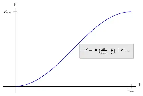

Assume everything is in the $\hat x$ direction for convenience. If we take a simple force like
${\bf F}(t) = \sin(\frac{\pi t}{t_{max}} - \frac{\pi}{2}) + F_{max}$
Force over time.

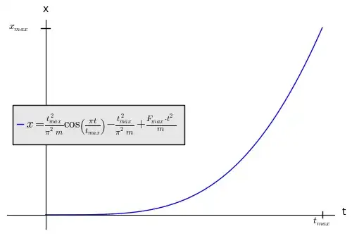

$x = \frac{F_{max} t^2}{2m}+\frac{t_{max}^2}{\pi^2 m} \cos(\frac{\pi t}{t_{max}}) + v_0 t + x_0 - \frac{t_{max}^2}{\pi^2 m}$.
In the simple case of zero initial velocity and position,
$x = \frac{F_{max} t^2}{2m}+\frac{t_{max}^2}{\pi^2 m} \cos(\frac{\pi t}{t_{max}}) - \frac{t_{max}^2}{\pi^2 m}$.
Distance over time with changing force.
