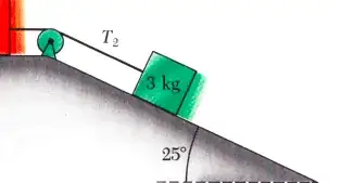

I'm interested an application of hooke's spring equations to solve for the position of an object with respect to time in the following scenario:
Where $T_2$ is a spring with coefficient $k$. I assume the incline is infinitely long to the right and am interested in the distance moved along a coordinate system rotated by $\theta$, i.e. $x(t)$ along the incline itself. This simplifies it by making it a one-dimensional problem, whose solution can be generalized.
Because I've been accosted in the past for asking homework questions, when in fact the question cam from my own mind, I will note on the onset that this diagram was borrowed from an unrelated problem in the textbook – which is why $T_2$ is drawn as a rope not a spring.
What I have tried
I'm looking for $x(t)= d(t)+x_0$, the position with respect to time, where $d(t)$ is the displacement with respect to time. Setting distance at which the spring is at rest as the origin, we have $x(t)=d(t) \implies x=d$
From the diagram, the leftwards force of the spring is $F_s=kd$ and the rightwards force of gravity is $mg\sin(\theta)$.
Thus the net force: $$F_{net} = ma = kd-mg\sin(\theta)$$
Solving for $a$, we have: $$a=\left(\frac{k}{m}\right)d-g\sin(\theta)$$

You can't really solve this by simple integration because the equation of motion is a 2nd order differential equation.
Imagine an $x$-axis parallel to the incline and pointing right (and somewhat down).
The Newtonian equation of motion is now:
$$ma=-kx+mg\sin \theta \tag{1}$$
Where $\theta$ is the angle between horizontal and incline. With $a=\frac{d^2x}{dt^2}=\ddot{x}$, $(1)$ becomes:
$$m\ddot{x}+kx-mg\sin \theta=0\tag{2}$$
$(2)$ would be a simple 2nd order differential equation for which standard solutions exist, if it wasn't for that niggling $mg\sin \theta$ tail, so first we get rid of that with a little trick.
Divide both sides by $m$ and define:
$$\omega^2=\frac{k}{m}$$
This gives:
$$\ddot{x}+\omega^2x-g\sin \theta=0\tag{3}$$
Now substitute:
$$u=\omega^2x-g\sin \theta\tag{4}$$ $$\implies \dot{u}=\omega^2\dot{x}$$ $$\implies \ddot{u}=\omega^2\ddot{x}\implies \ddot{x}=\frac{1}{\omega^2}\ddot{u}$$ Into $(3)$ we get: $$\frac{1}{\omega^2}\ddot{u}+u=0$$ Multiply both sides by $\omega^2$ to get: $$\ddot{u}+\omega^2u=0\tag{5}$$ $(4)$ is the classic 2nd order linear homogeneous (ordinary) differential equation and it has the general solution:
$$u(t)=c_1\cos \omega t+ c_2\sin \omega t$$
To determine the integration constants $c_1,c_2$ we need initial conditions:
$x(0)=x_0$, which is the displacement at $t=0$. We also assume that at $t=0$, $v=\dot{x}=0$. Use $(4)$ to define $u(0)$, then $\dot{u}(0)$ and use these expressions to work out $c_1$ and $c_2$.
This gives you a full expression for $u(t)$ and with $(4)$:
$$u(t)=\omega^2x(t)-g\sin \theta$$
Extract $x(t)$ from there, for a full description of displacement in time. It's the kinematic equation of a simple harmonic oscillator with angular velocity $\omega=\sqrt{\frac{k}{m}}$.
Alternative substitution to $(3)$ (starting from $(2)$):
$$u= kx-mg\sin \theta$$
This also works and leads to the same end result.
