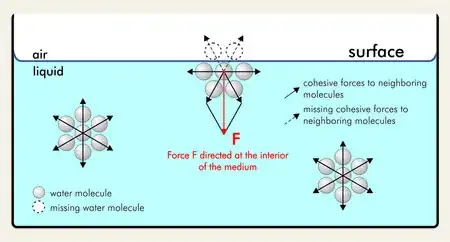

The surface tension of a liquid results from an imbalance of intermolecular attractive forces, the cohesive forces between molecules: A molecule in the bulk liquid experiences cohesive forces with other molecules in all directions. A molecule at the surface of a liquid experiences only net inward cohesive forces
If this is the case: Why is surface tension considered or experienced as a force parallel to the interface while it is so obvious that it must be perpendicular to it?

This is indeed very confusing. I think of it like this. Note this approach is purely conceptual and not at all rigorous! For a general definition of Force as the change of potential
$$ F_x= -dV/dx $$
As you can see in the image, when a water molecule reaches the surface there has been work done on that molecule via the Hydrogen Bonds, an electrostatic force.
