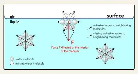

Like in this figure we see that the surface molecules have a net downward force to all of these so should any force which we made along a line on the surface the force be downwards ? Why the surface tension is parallel to the surface ?
Why surface tension direction cannot be downwards in direction when considered the surface of fluid?

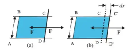

The existence of a surface with unsatisfied bonds produces an energy penalty. This results in an internal Laplace pressure, an increase in the chemical potential of the system, and a resistance to increasing the surface area: the surface tension. Since you'd apply a force parallel to the surface to extend the area, as shown below, the corresponding restoring force is also parallel to the surface.
Chemomechanics
- 30,163
Its a little like the definition of friction. The force components parallel to the surface are called the surface tension. The downward component is what works against evaporation.
