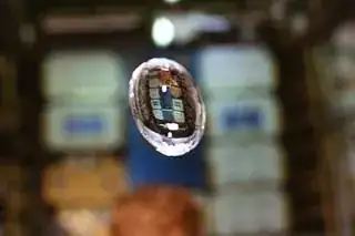

To simplify, let's consider a weightless blob of water in the Space Station, not touching anything
water blob
The water molecules all attract one another.
Inside the water blob, they can approach freely and then move away, attracted by others.
They move around inside the droplet.
On the surface of the water blob, there is nothing outside to attract them, and only the molecules inside to attract them back inside.
You will understand that this surface is not fixed like a skin. The molecules that happen to be there, are all trying to get back inside, and some will, so being replaced by an "unfortunate" molecule being pushed outwards.
For a given molecule, the force pulling inwards concerns only its competition with others to get inside. It's the (tangential) attraction by surface neighbours that makes the whole surface behave instantaneously like an elastic skin, trying to diminish as much as possible and so make the blob spherical.
