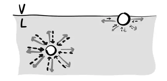

Paper explaining why surface tension is parallel to the interface:
Away from the surface there is perfect force balance due to the symmetry around a molecule. Near the interface, however, the up-down symmetry is broken. To restore the force balance in the vertical direction, the upward repulsive arrow (dashed) has to balance the downward attractive arrow (solid). In the direction parallel to the interface, the symmetry is still intact, thus automatically ensuring a force balance parallel to the interface. This balance means that along the direction parallel to the interface, there is no reason why the attractive forces should have the same magnitude as the repulsive forces. In practice, the attractive forces are stronger, giving rise to a positive surface tension force.
This was the diagram provided in the paper:
This is my intuition for the question title: ( Is the density greater on the interface or less dense? )
Consider the molecule at the interface. The force balance on this molecule is broken creating a net force downwards that minimises surface area. However, because this molecule doesn't keep accelerating downwards it must eventually be balanced by the repulsive forces of molecules below. At this point where the attractive and repulsive forces are balanced the molecules must be more compact. Hence I think the surface of the fluid must be more dense than the bulk. Because the surface is denser than there exists more attractive forces giving rise to surface tension.
Is the above intuition correct and that a fluid's surface is indeed denser than the bulk? Or is there a flaw in the explanation above? If so, an alternative explanation would be extremely helpful.

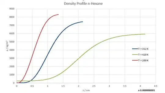

To the Density Question:
Whether the fluid density increases or decreases depends on the other phase involved. In your example the figure shows a liquid/vapour interphase. Since the density changes continuously from liquid to vapour, the liquid density has to decrease from it's liquid bulk value to it's vapour value. See the fig. below for a density profile of liquid n-Hexane in equilibrium with it's vapour. It shows the density plotted vs the vertical distance z. z=0 is here set to the vapour bulk density, z=infinity is the liuid bulkd density. An "s-curve" starting at low densities (vapour) and changing continuously to high density (liquid) also shows the size of the interface. The higher the temperature, the larger the interface. This goes up to the critical point, at which the interface gets infinitely large, or, equivalently, no difference between vapour and liquid can be detected anymore. Plot of the Density Profile of n-Hexane at 3 different Temperatures (own work, based on square gradient theory)

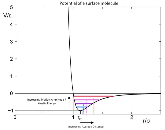

As the intermolecular attraction force is weak on surface molecules and they feel repulsion from only one side, the molecules have greater kinetic energy than of the bulk molecules. In the bulk, molecules of the fluid experience strong intermolecular attraction and repulsion from every side that causes their kinetic energy to be lower. Having greater kinetic energy implies that surface molecules have greater average distance between them ('average' is used because its impossible to calculate distance between every pairs of molecule). And greater average distance means greater volume which implies less density.
