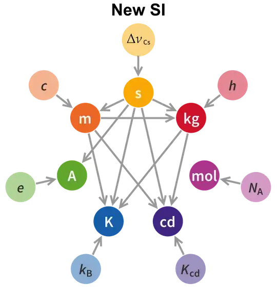

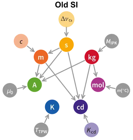

So the BIPM has now released drafts for the mises en pratique of the new SI units, and it's rather more clear what the deal is. The drafts are in the New SI page at the BIPM, under the draft documents tab. These are drafts and they are liable to change until the new definitions are finalized at some point in 2018. At the present stage the mises en pratique have only recently cleared consultative committee stage, and the SI brochure draft does not yet include any of that information.
The first thing to note is that the dependency graph is substantially altered from what it was in the old SI, with significantly more connections. A short summary of the dependency graph, both new and old, is below.
In the following I will explore the new definitions, unit by unit, and the dependency graph will fill itself as we go along.

The ampere
The ampere is getting a complete re-working, and it will be defined (essentially) by fixing the electron charge $e$ at (roughly) $1.602\,176\,620\times 10^{–19}\:\mathrm C$, so right off the cuff the ampere depends on the second and nothing else.
The current definition is couched on the magnetic forces between parallel wires: more specifically, two infinite wires separated by $1\:\mathrm m$ carrying $1\:\mathrm{A}$ each will attract each other (by definition) by $2\times10^{-7}\:\mathrm{N}$ per meter of length, which corresponds to fixing the value of the vacuum permeability at $\mu_0=4\pi\times 10^{-7}\mathrm{N/A^2}$; the old standard depends on all three MKS dynamical standards, with the meter and kilogram dropped in the new scheme. The new definition also shifts back to a charge-based standard, but for some reason (probably to not shake things up too much, but also because current measurements are much more useful for applications) the BIPM has decided to keep the ampere as the base unit.
The BIPM mise en pratique proposals are a varied range. One of them implements the definition directly, by using a single-electron tunnelling device and simply counting the electrons that go through. However, this is unlikely to work beyond very small currents, and to go to higher currents one needs to involve some new physics.
In particular, the proposed standards at reasonable currents also make use of the fact that the Planck constant $h$ will also have a fixed value of (roughly) $6.626\,069\times 10^{−34}\:\mathrm{kg\:m^2\:s^{-1}}$, and this fixes the value of two important constants.
  • One is the Josephson constant $K_J=2e/h=483\,597.890\,893\:\mathrm{GHz/V}$, which is the inverse of the magnetic flux quantum $\Phi_0$. This constant is crucial for Josephson junctions, which are thin links between superconductors that, among other things, when subjected to an AC voltage of frequency $\nu$ will produce discrete jumps (called Shapiro steps) at the voltages $V_n=n\, \nu/K_J$ in the DC current-voltage characteristic: that is, as one sweeps a DC voltage $V_\mathrm{DC}$ past $V_n$, the resulting current $I_\mathrm{DC}$ has a discrete jump. (For further reading see here, here or here.)
    Moreover, this constant gives way directly to a voltage standard that depends only on a frequency standard, as opposed to a dependence on the four MKSA standards as in the old SI. This is a standard feature of the new SI, with the dependency graph completely shaken for the entire set of base plus derived units, with some links added but some removed. The current mise en pratique proposals include stabs at most derived units, like the farad, henry, and so on.
  • The second constant is the von Klitzing constant $R_K = h/e^2= 25\,812. 807\,557 \:\Omega$, which comes up in the quantum Hall effect: at low temperatures, an electron gas confined to a surface in a strong magnetic field, the system's conductance becomes quantized, and it must come as integer (or possibly fractional) multiples of the conductance quantum $G_0=1/R_K$. A system in the quantum Hall regime therefore provides a natural resistance standard (and, with some work and a frequency standard, inductance and capacitance standards).
These two constants can be combined to give $e=K_J/2R_K$, or in more practical terms one can implement voltage and resistance standards and then take the ampere as the current that will flow across a $1\:\Omega$ resistor when subjected to a potential difference of $1\:\mathrm V$. In more wordy language, this current is produced at the first Shapiro voltage step of a Josephson junction driven at frequency $483.597\,890\,893\:\mathrm{THz}$, when it is applied to a resistor of conductance $G=25\,812. 807\,557\,G_0$. (The numbers here are unrealistic, of course - that frequency is in the visible range, at $620\:\mathrm{nm}$ - so you need to rescale some things, but it's the essentials that matter.
It's important to note that, while this is a bit of a roundabout way to define a current standard, it does not depend on any additional standards beyond the second. It looks like it depends on the Planck constant $h$, but as long as the Josephson and von Klitzing constants are varied accordingly then this definition of the current does not actually depend on $h$.
Finally, it is also important to remark that as far as precision metrology goes, the redefinition will change relatively little, and in fact it represents a conceptual simplification of how accurate standards are currently implemented. For example, NPL is quite upfront in stating that, in the current metrological chain,
All electrical measurements below 10 MHz at NPL are traceable to two quantum standards: the quantum Hall effect (QHE) resistance standard and the Josephson voltage standard (JVS).
That is, modern practical electrical metrology has essentially been implementing conventional electrical units all along - units based on fixed 'conventional' values of $K_J$ and $R_K$ that were set in 1990, denoted as $K_{J\text{-}90}$ and $R_{K\text{-}90}$ and which have the fixed values $K_{J\text{-}90} = 483.597\,9\:\mathrm{THz/V}$ and $R_{K\text{-}90} = 25\,812.807\:\Omega$. The new SI will actually heal this rift, by providing a sounder conceptual foundation to the pragmatic metrological approach that is already in use.

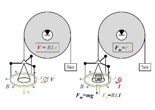

The current proposed mise en pratique for the kilogram contemplates two possible implementations of this standard, of which the main is via a watt balance. This is a device which uses magnetic forces to hold up the weight to be calibrated, and then measures the electrical power it's using to determine the weight. For an interesting implementation, see this LEGO watt balance built by NIST.
To see how these devices can work, consider the following sketch, with the "weighing mode" on the right.
Image source: arXiv:1412.1699. Good place to advertise their facebook page.
Here the weight is attached to a circular coil of wire of length $L$ that is immersed in a magnetic field of uniform magnitude $B$ that points radially outwards, with a current $I$ flowing through the wire, so at equilibrium $$mg=F_g=F_e=BLI.$$ This gives us the weight in terms of an electrical measurement of $I$ - except that we need an accurate value of $B$. This can be measured by removing the weight and running the balance on "velocity mode", shown on the left of the figure, by moving the plate at velocity $v$ and measuring the voltage $V=BLv$ that this movement induces. The product $BL$ can then be cancelled out, giving the weight as $$mg=\frac{IV}{v},$$ purely in terms of electrical and dynamical measurements. (This requires a measurement of the local value of $g$, but that is easy to measure locally using length and time standards.)
So, on one level, it's great that we've got this nifty non-artefact balance that can measure arbitrary weights, but how come it depends on electrical quantities, when the new SI kilogram is meant to only depend on the kinematic standards for length and time? As noted in the question, this requires a bit of reshuffling in the same spirit as for the ampere. In particular, the Josephson effect gives a natural voltage standard and the quantum Hall effect gives a natural resistance standard, and these can be combined to give a power standard, something like
the power dissipated over a resistor of conductance $G=25\,812. 807\,557G_0$ by a voltage that will produce AC current of frequency $483.597\,890\,893\:\mathrm{THz}$ when it is applied to a Josephson junction
(with the same caveats on the actual numbers as before) and as before this power will actually be independent of the chosen value of $e$ as long as $K_J$ and $R_K$ are changed appropriately.
Going back shortly to our NIST-style watt balance, we're faced with measuring a voltage $V$ and a current $I$. The current $I$ is most easily measured by passing it through some reference resistor $R_0$ and measuring the voltage $V_2=IR_0$ it creates; the voltages will then produce frequencies $f=K_JV$ and $f_2=K_JV_2$ when passed over Josephson junctions, and the reference resistor can be compared to a quantum Hall standard to give $R_0=rR_K$, in which case $$ m =\frac{1}{rR_KK_J^{2}}\frac{ff_2}{gv} =\frac{h}{4}\frac{ff_2}{rgv}, $$ i.e. a measurement of the mass in terms of Planck's constant, kinematic measurements, and a resistance ratio, with the measurements including two "artefacts" - a Josephson junction and a quantum Hall resistor - which are universally realizable.
