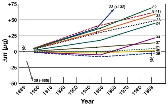

However, as you note again, the mass of the IPK and its replicas is subject to change over time: they lose mass when they're polished, and they gain mass through corrosion from air. This is in fact a problem: when sister copies are compared to each other and to the IPK, their mass changes by a few tens of micrograms over the decades:
Image source.
This has some pretty profound consequences for all of metrology, because it means that mass standards are only stable to roughly the $10^{-8}$ level on decade-long timescales. In turn, that affects every measurement that depends on the mass standard to a finer precision.
Does this sort of thing bother metrologists? You bet it does. Unfortunately, until recently there simply wasn't any suitable alternative - there wasn't any suitable measurement of mass that was precise and stable enough to compete with the IPK. That feels weird (surely we can do better than $10^{-8}/\mathrm{decade}$) but that's how it is.
