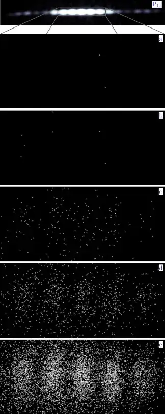

You are probably referring to the Feynman-style double-slit experiment, done with individual electrons. A recent experimental realization of this was reported in
Controlled double-slit electron diffraction. R Bach et al. N. J. Phys. 15 033018 (2013) (open access).
and it is described in more readable detail in
Feynman's double-slit experiment gets a makeover. H Johnston, Physics World, 14 March 2013.
The experimental data looks like this, which you might recognize:
Image source: Bach et al., CC-BY license.
The experiment is in essence really simple: simply take an electron gun (i.e. a cathode-ray tube like you find in old TVs, simply a heated piece of metal that's negatively charged) and dial it down to bring the current to levels where there is only one electron in the system at a time. If your detector is sensitive enough, then you will be able to detect individual electron hits.
The detector in this experiment was a microchannel plate (a metal plate with lots of tiny holes in it), to discretize the electron positions, with a phosphorescent screen behind it to change the electron hits into light, which is then imaged with a (fancy, low-light, but otherwise perfectly normal) camera.
