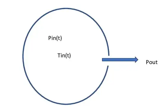

Let's look inside the can again.
To understand the effect of a leak in a can of gas, imagine a thin membrane
dividing the gas which is about to escape from the gas which will remain. As
the gas escapes this membrane moves and the gas within it expands. That
expansion is, to good approximation, adiabatic. To prove this we need to claim
that there is no heat transfer across this membrane. There will be no heat transfer
