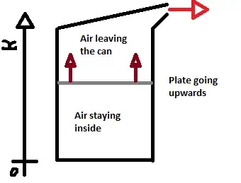

Emptying a canister filled with compressed gas is the same as extending a piston filled with air. You can consider that a plate is positioned horizontally separating the air in two : above is the air that will exit the canister and under is the air staying within.
Canister emptying. Hope y'all like this magnificent drawing of mine
Simple answer :
Since the plate is moving, when a particle hits it, it will bounce back but with a slower speed : the movement of the plate absorbs the impact. Since temperature is strongly linked to the speed of the particle (more accurately to their energy) the movement of the plate causes a drop in temperature.
