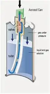

A typical aerosol spray can looks something like this:
Aerosol
(image from the Aerosols Wiki - yes, that really does exist :-)
When you use the spray a small amount of the liquid is expelled. The liquid evaporates as it passes through the nozzle and this creates the spray. The evaporation at the nozzle is why the spray is cold.
As for the can, there will be some degree of cooling due to expansion of the gas, but this will be negligible for a couple of reasons. Firstly the volume of the liquid decreases by a relatively small amount, because a small amount of liquid creates a large volume of spray. This means the gas above the can increases in volume only a small amount so the adiabatic cooling is small. Secondly the specific heat of the gas is small compared to the can and the liquid, so the gas is quickly reheated by its surroundings with very little temperature change to the walls of the can and the liquid.
The evaporative cooling happens because the pressure of the gas above the liquid is equal to the vapour pressure of the liquid propellant. When you use the spray the pressure inside the can falls, so the liquid propellant evaporates to restore the pressure to the vapour pressure of the propellant. It is the latent heat associated with this evaporation that causes the cooling of the can. The latent heat of evaporation is relatively large so the temperature drop associated with the evaporation is significant.
