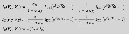

which is only a part of the slightly more detailed model that includes the effects of both junctions. Forgive me for using the rather ancient convention adopted in Millman & Halkias (either Electronic Devices, Sec. 9-5 "Detailed study of the currents in a transistor", p. 229, or Integrated Electronics, Sec. 5-12 "Analytical Expressions for Transistor Charateristics", p. 145) but I have both direct and inverse relationship in that form already typed:
both ebers moll equations from Millman
The point I want to make is that these equations can be inverted to show voltages as a function of currents
inverse ebers moll from above
There is nothing special in expressing V as a function of I or I as a function of V. To my knowledge cause and effect are not embedded in the equations. And when V and I refer to voltage across and current into the same PN junction there is no point in trying to determine which one is causing the other.

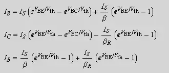

Let's leave Millman in the past and go back to the twenty-first century: a more modern approach to modeling the transistors guts is by using the transport model (and again different conventions, sorry...but at least this is a modern one where \$I_E = I_C + I_B\$ and the voltages are the more familiar \$V_{BE}\$ and \$V_{BC}\$.)
transport equations

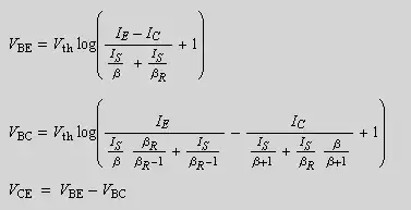

Note that if we want to, we can invert these equations as well - just solve the first two for \$V_{BE}\$ and \$V_{BC}\$ and use KVL for the \$V{CE}\$ :
inverse transport equations
Irregardless of how you see the above equations, expressing currents in terms of voltages or as voltages in terms of currents, you will always find at least a current and a voltage that are 'concomitant' since they refer to the same junction: \$I_E\$ and \$V_{BE}\$ are concomitant, \$I_C\$ and \$V_{BC}\$ are concomitant, \$V_{BE}\$ and \$I_B\$are concomitant.

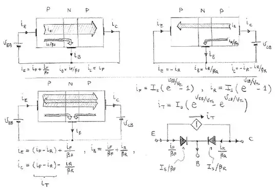

Who plays first, in base?
So, let's go back to your transistor example (a word of advice: I find it easier to use PNPs to see what happens inside a BJT, looks more 'natural' so - I will avoid naming the majority or minority carriers explicitly) and let me magically materialize an offending charge carrier in base (you should actually think statistically - when I say 'one carrier' I mean a bunch of carriers for which you can find an average behavior.) Its field will disturb the equilibrium and either it will draw opposite charge towards itself or it will be attracted to opposite charges (at the same time, since we live at temperatures higher than 0 K, it will undergo diffusion). It is highly likely that it will recombine with a carrier of opposing charge and in the end the charge that will reestabilish the equilibrium will have to come from outside the device. The emitter is in the ideal position to provide just that.
Since we are dealing with semiconductors of different types, when the emitter supplies what for it is a majority carrier, the base will be entered by what it sees as a minority carrier. This carrier (actually a bunch of carriers) will diffuse like a gas and will not go straight to the offending extra charge to be neutralized. If the base is thin enough, before it even knows it, the carrier will find itself near the collector junction where the electric field in the depletion region (mind you, that field was there before I even thought to materialize a carrier) will divert it from its intended mission and send it to the collector contact. As a matter of fact, out of say 100 charges the emitter is supplying to the base, 99 will be swept away by the collector.
(This is an oversimplified picture, in reality we should take into account, at least, the carriers lost by recombination in the base and the different lifetimes of electrons and holes, also and the actual movement of charges is a bit more convoluted as there are other contributions to the outside currents, but the point is that the carrier you inject in base alters the dynamical equilibrium and the depletion zone so that the big flow of carriers that goes from emitter to collector will change accordingly - you can read about it on Streetman.)
The more carriers you manage to put into the base, the more carriers the emitter will have to inject to neutralize them, but since it appears to have the shooting ability of a starship trooper, the great majority of these carriers will end up in the collector.

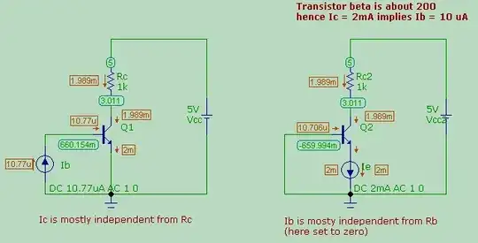

setting Ic by forcing Ib and Ie
A solar cell can act as a reasonably well behaved current source. The output current will be proportional to the luminous flux and if you put that current into the base of a transistor the output transistor current will be proportional to the luminous flux. Why should you worry about Vbe at all? It will necessarily assume the value required to accomodate the Ib you set by illuminating the cell.
So, yes, your intuition is right. You can see the transistor also as working in this way, as a current controlled device.

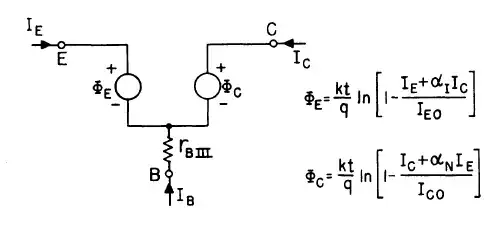

It should be recalled from the definitions of PHI_E and PHI_C that they are the voltage of the p material relative to the n material. Hence these equations apply for both n-p-n and p-n-p transistors. [...] Eqs. (27) and (28) lead to the equivalent circuit shown at the top of Fig. 6
Ebers Moll equivalent circuit
What's funny is that this is the original 1954 Ebers and Moll paper "Large-Signal Behavior of Junction Transistors"
