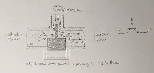

The hydraulic model of the BJT
The hydraulic model works best when referred to an NPN transistor: here water flow will be conventional electric current flow and we will now see the base current to actually add to the collector current to produce Ie. Still, we will be able to see how, once the transistor is conducting (i.e. the conduit is open), the presence of the base flow is required to keep it open.
Hydraulic model of a BJT
In the figure above, a small base water flow is required to move a piston that blocks the main flow of water from collector to emitter (remember, we are using conventional current now). Note that we can control the position of the piston by either using flow or pressure, and that you cannot have one without the other.
A gravitational pump (or a constant torque rotating pump) is an example of voltage generator equivalent. If the base conduit is vertical and oriented as in figure, adding water will increase the weight of the column of liquid, thus increasing the pressure in the base circuit to the point where the spring won't be able to keep it in position. As the piston moves downwards, a base current will necessarily flow (and merge with the collector-to-emitter flow).
What about current generators? A peristaltic pump, or a gear pump (or any rotating constant velocity pump) are examples of hydraulic current source equivalent. As you move the liquid at a fixed rate in the base comduit, since water is uncompressible, the piston will necessarily have to move to let the water pass.
Of course since flow and pressure are conjugated variables you can't have one without the other and the movement of water in the base conduit is associated with an increase in pressure against the piston (that's what develops the force that counters the springs attraction).

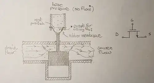

Bonus track: comparison with the MOSFET
The hydraulic model of the BJT implies both pressure and flow must be simultaneously present to keep the piston down. How does it differ from the hydraulic model of a MOSFET? Have a look at the figure below:
Hydraulic model of a MOSFET
Here we only have the option of applying pressure because the gate hydraulic circuit is separated from the drain-source conduit and only acts on a rubber membrane (the hydraulic equivalent of a capacitor). A little current is necessary at the beginning to fill the volume difference due to the stretched position of the membrane. Once the piston is in the desired position no more fluid will need to flow and all you need to keep the channel open is just the pressure. If you were to use a peristaltic pump, instead, the pressure against the membrane would increase until it blows.

In the case of the MOSFET, you need a temporary current to bring or remove charges from the gate (still no voltage without a concomitant current), but after that you no longer need to maintain it.
