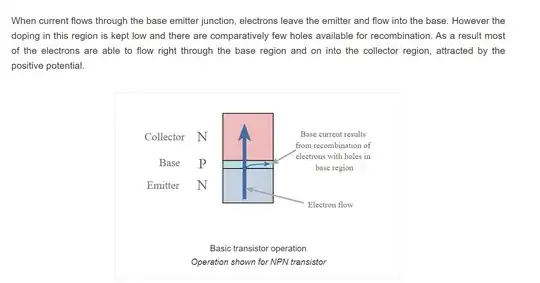

Here is a link to an introduction to transistors article that I found that may help you get started:
Transistors
Here is a short excerpt from that article:
NPN operation
jwh20
  • 7,917
  • 17
  • 28
