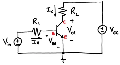

With BJTs, we can control base current using Vin (from diagram). Why do textbooks state that BJTs are current controlled when it's obvious that changing the voltage controls the current through the collector? enter image description here

  • could you please post the jpg as a png and use the image tool? Or draw the circuit with the circuit editing tool? – Voltage Spike Aug 17 '16 at 15:57
    Just to complicate your life, a BJT isn't current controlled. See full set of simplified DC-only Ebers-Moll model equations here (injection, transport, and non-linear hybrid-pi): http://electronics.stackexchange.com/questions/252197/why-is-vbc-absent-from-bjt-equations/252199#252199 – jonk Aug 17 '16 at 16:29
  • http://www.zen22142.zen.co.uk/Theory/re_model.htm – Voltage Spike Aug 17 '16 at 17:07
    good grief... in circuits like those depicted in the drawing, nobody is thinking about Ebers-Moll or Hybrid-pi models. You pretty much have to be doing AVLSI to be concerned with that stuff. – vicatcu Aug 17 '16 at 20:53
    @Raj, remove R1, and then we'll see that the interior of a BJT is indeed controlled by Vbe. But that design approach is mostly for discrete diff-amp designs (such as the inside of modern DC-coupled audio amplifiers.) Instead we can ignore the interior BJT physics, and pretend that Ib determines Ic directly, even though it really doesn't. This also avoids having to deal with any nonlinear xfer functions produced by diode junctions. – wbeaty Aug 18 '16 at 05:18
  • I used to think that BJT were current controlled device. Until more recently when I really started reading textbooks again, they all say the same thing - BJT are voltage controlled devices. Sedra-Smith which is a very popular micro-electronics book. As @LvW said in his answer - this has become a religious debate. – efox29 Aug 22 '16 at 02:06
  • You answered your own question.. The resistor R1 is creating a current source that sets a specfic current into the base of the bjt. That sets the collector current. The other resistor R2 converts current back to voltage at the output. You need to make R1 small if you need a large collector current, but voltage Vin stays the same. Or you can increase Vin. Both accomplish allowing more current into the base at the same time forward biasing vbe. You bias a circuit with resistors when designing amplifiers to keep it linear with beta equations and not use the non linear vbe equation. Feedback works – Analog Arsonist Aug 22 '16 at 03:18

In the above circuit Vin is controlling the current going to the base, not the voltage drop across the base and emitter of the transistor itself.
The voltage drop across Vbe will always be around 0.7V for Vin > 0.7; the excess voltage will be dropped across the R1.
By changing Vin, you are actually controlling the current going to the base based on the equation:
$$I_B = (Vin-0.7V)/R1$$

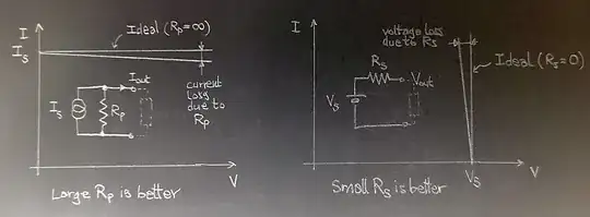

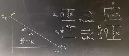

Let's start with a little digression in basic circuit theory: what makes a generator a current generator instead of a voltage generator? Look at the V-I characteristics: the one with mostly constant current (almost horizontal in the V-I plane) will be called current generator; the one with mostly constant voltage (almost horizontal in the I-V plane, and almost vertical in the V-I plane) will be called a voltage generator.
Current and voltage generators characteristics on the VI plane
What does this mean, in practice? That a current generator is able to supply a given current almost independently from the load (but the voltage across it will change accordingly to the value of the load resistance), while a voltage generator is able to supply a given voltage almost independently from the load (and in this case it's the current that will adapt to the load.)
The presence of an internal resistance kind of blurs the line between current and voltage generators, since depending on the scale of the horizontal and vertical axes we can show the characteristic as almost vertical or almost horizontal. In reality a linear generator with a non-zero internal resistance can be considered either type (and converted to the conjugate type by means of Thevenin's and Norton's transformations):
A non-ideal linear generator and its Thevenin and Norton equivalents
Generally speaking, a current generator has a very large internal resistance (ideally infinite), while a voltage generator has a very small internal resistance (ideally zero); when the internal resistance value is finite, 'large' and 'small' are concepts relative to the magnitude of the load and the admissible intervals of voltage and current for the particular circuit the generator is part of.

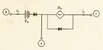

Simplified Device Model for the BJT
This is probably the first reason why the BJT is considered a current controlled device. This is the simplest model for the BJT, as shown by Chua, Desoer and Kuh in their "Linear and Nonlinear Circuits":
simplest piecewise linear model for the BJT
in the above picture all diodes are ideal (threshold voltage is zero, and so is series resistance; these are perfectly open circuits when reverse biased and perfect shorts when forward biased). E0 adds a threshold voltage to the input characteristic, while transistor action is expressed by ic = beta * ib (in the textbook's notation). Note that current-controlled current generator. Here are the corresponding input and output characteristics

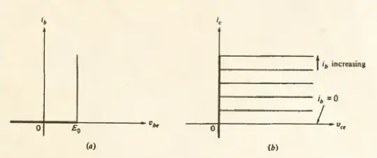

simplest piecewise linear characteristics for the BJT
Pretty simple, right? You can compare them with actual characteristics and see that they resemble them, though. Simple as it is, this is a legit model and can be used to model circuits like a common emitter one shown later where, by changing ib (you can't change Vbe in this model, since it's fixed) you modify the value of Ic. You can see how you can make ib change by intersecting the input characteristic with the input generator's load line By changing the voltage E1 (not part of the BJT) you change ib (part of the BJT) while vbe is constant at exactly E0. Then you can find the value of ic corresponding to that value of ib, select the corresponding output characteristic and find the voltage by intersection with the output load line.

The extremely simplified behavior of this model shows why many textbooks state that BJTs are current controlled. The actual input characteristic resemble that vertical line where you can only vary ib, and not vbe, whose value is considered fixed.

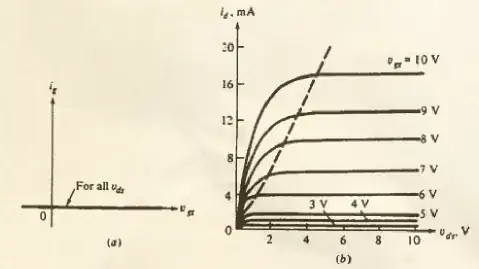

You might want to compare this model with the simplest model for a MOSFET: page 151 of Chua has that one too.
simplest MOSFET characteristics

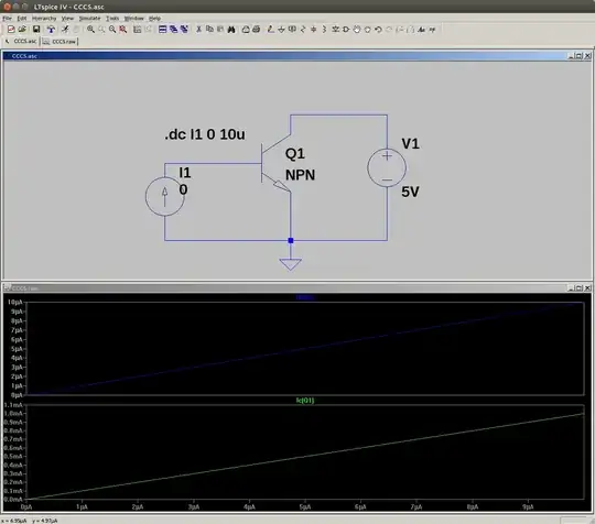

As you can see, the gate current is fixed (at zero to be pedantic), a condition dual to that shown in the BJT: the I-V input characteristic is horizontal. The only control you have here is by means of vgs. Does this mean we are negating the existence of the tunnel effect? Nope, this is just a model. A simplified model that, among other things, does not consider tunneling but still manages to show why in a MOSFET you act on the gate-source voltage.

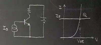

If you use pure current control:
You can use
$$ I_C = \beta \, I_B $$
to find the value of ib that you have to set. A simple division will show that the nominal values of 10 and 15 mA of ic require nominal values of 40 and 60 uA for ib. Given the accuracy of your current generator, you will expect to see the following current ranges in input and output:
ib = 36-44 uA --> ic = 9-11 mA
ib = 54-66 uA --> ic = 13.5-16.5 mA
A bjt driven by an ideal current source

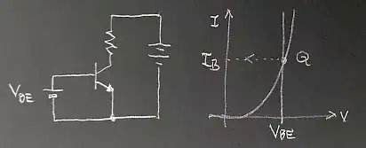

If you use pure voltage control:
You can't use \$I_B = I_C/\beta\$, so you must specify a voltage that create a VBE of... Yes, of what?
$$V_{BE} = V_{Th} log(\frac{I_C}{I_S})$$
A BJT driven by an ideal voltage source
You can either compute the logarithm, or use the full Ebers-Moll model to compute the value, or maybe ask the manufacturer to provide you with a suitable chart. But let's say you've determined it's precisely 0.705 and 0.719V (these values come from a simulation.)
When you set those precise values, your low-cost ±10% accurate generator will supply a voltage with the following uncertainties
0.6345 - 0.7755 V --> back to Ebers-Moll, to compute ic, ... too bad the uncertainty will be exponentiated...
0.6471 - 0.7909 V V --> no, wait, before computing...
...it appears we already have a superposition in the voltage ranges we are supplying: we might not be able to distinguish even days from odd ones.
The figure at the beginning of this subsection summarizes how current control is the preferred way to drive your transistor. With current control, even if we allow a ±10% error on the measured value of beta, we can still (barely, but still) make out the two ranges of current (9 - 11 mA vs 13.5 - 16.5 mA) corresponding to odd and even days.
With voltage control, if we add a ±10% error on the computed (or graphically deduced) value of voltage, you are already lost in VBE uncertainty. And if that wasn't enough, that uncertainty will also be amplified to an even worse uncertainty in the values of IB and IC.

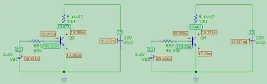

Example 1: battery + resistor
In our first example we will use a 3.3V voltage (!) generator and a base resistor (actually two base resistors to be determined: one for odd days, the other for even days). A 'voltage control guy' would use this components to set the controlling voltage between emitter and base, while a 'current control guy' would use it to set the controlling current into base. Our goal is to find the two values of RB that will result in IC = 10 mA, and IC = 15 mA for a BJT of known (measured, certified) beta of 250.
A BJT driven by a real source with a slanted characteristic line
Current control guy's job is easy: the controlling variable is ib, so given the values of 40 and 80 uA (with the above errors) one can compute
$$R_B = \frac{V_{Batt} - V_{BE}}{I_C / \beta}$$
even by assuming VBE constant and equal to 0.7V (uncertainties are on my side). With a know beta of 250, the results are RB1 = 65 kohm, and RB2 = 43.3 kohm. Here are the simulations IC = 10.26 mA in the first case, and IC = 15.37 mA for the second one. I'd consider this a success in current control.
Setting Ic = 10mA and Ic = 15mA with a real world generator.
Is the input one-port behaving more like a voltage generator, or more like a current generator?
I am not getting into the design procedure of the 'voltage control guy' (ask them how they arrive to determine the values with real components).
Irregardless on the procedure followed to 'design' the two circuits, let's see what the BE diode of the BJT sees. It's a small battery in series with a reasonably high resistance. I say this behaves more like a current generator than a voltage generator. If we plot the VI characteristic of the one port formed by Vbatt and RB (for RB = 65 kohm and RB = 43.3 kohm) on a range of typical base-emitter voltages (0.5 to 1.2 V) and base currents (0 to 200 uA) we see this:
Within these ranges, it looks like the BJT is driven by a reasonable approximation of a current generator
If we superpose the load line represented by the exponential characteristic of the diode, we obtain a figure that is essentially the same as the one drawn for pure current control. Makes sense, since the large series resistance RB serves the purpose of turning the ideal voltage generator (battery) into something that resembles a current generator.

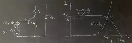

It's clear that this cell alone won't be operating in the constant current region, but it will instead appear as a weak voltage generator, incapable of driving the transistor as we wish.
But if we put two such cells in series, their combined characteristic will have the same short circuit current and double the open circuit voltage. Now the intersection of generator (solar cell) and load (the BE diode) will be in a better position, near the region where the current appear to be constant. If we use three cells in series, we achieve a reasonably stiff constant current generator: it will deliver 50 uA for a wide range of loads, including the load represented by the BJT base-emitter junction.
A double cell circuit results in a better operating point
Now, this is not only a current generator from the point of view of the characteristic line in the VI plane, but it is also a current generator in that we set the current by setting the illumination of the cell. N photons per second striking the active area of the cell will result in a current of k N electrons per second flowing in the copper terminals cross section. The value of the voltage across the series, on the other hand, depends on the load. And when we have 50 uA supplied by a series of 3 cells, we get -essentially - the same current we would get simulating an ideal generator.
Change the illumination and with the number of photons per second, the number of electrons per second will vary as well, causing a different value of collector current. It's going to be hard to assert that the voltage across the BE junction is causing the correct number of photons per second per unit area to fly into the solar cell.
With three solar cells, the BJT is driven by a constant current generator with current determined by cell illumination
I call this a practical example of almost ideal current control.

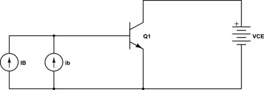

In reality we apply both current and voltage
Time to address the elephant in the room: the voltage/current religion war you might have witnessed. What is that all about? Some people point to the Ebers-Moll model, whose equations are usually expressed in the form of currents as a function of voltages, and say "see? the voltages determine the value of the currents, and this has to be a cause-effect relationship". Others go even a step further and state that "voltages cause currents and not the other way around".
I personally believe this point of view originates from the path usually followed when explaining transistors to students: at first it's the simplest model, where IC = beta IB and no math is required; then the exponential characteristic I = I(V) of the PN junction is explained (not mentioning that it can be expressed as a logarithmic relation V = V(I), as well), and then the Ebers-Moll model (in its I = I(V) form) is usually paraded as the ultimate transistor model where the truth lies. Furthermore, transistor are solid state devices whose inner working needs to be explained using the laws of quantum physics. Given the band structure of the energy levels of electric carriers in solids, it is natural to resort to energy levels to depict the inner workings of these devices. Energy and potential are closely related with each other, so most advanced models tend to express relevant quantities in function of potential (difference)s.
It is therefore easy, when following this path, to think that current control is a white lie told to first year students, while experienced and savvy engineers know Ebers-Moll and device physics, and it's clear to them that it's voltage that controls the currents in a BJT. Well, not so fast! For starters, the dependence on Vbe shown in the Ebers-Moll model is not implying a cause-effect relationship. It's just simpler to write the equations in that way. Nobody forbids you from using inverse functions. And this is not an opinion: the expression of the Ebers Moll model in the form V = V(I) can be found no less than in the original 1954 Ebers and Moll paper (and Millman's textbooks). And then there are charge control models of the BJT that go beyond voltage or current control.
Finally, the actual elephant: voltage and current are coupled quantities of the effort-flow sort, so that basically you can't have one without the other. It is a delicate matter, and one should consider what it means to create and sustain a voltage difference. Is it not created by displacing charges (by electrochemical reaction in a battery, by electromagnetic interaction in a mechanical generator)? I have ultimately grown the conviction that, in the end, all devices are basically charge controlled: you move charges from here to there and get a certain effect: current is the result of the movement of charges, voltage is the result of the presence of charges in space.
Consider the following alternative circuit:
schematic
Is it not obvious that
$$I_C = \beta_{DC}I_B$$
and
$$i_c = \beta_{ac}i_b$$
and thus that the base current controls the current through the collector?
Yes, you might object that changing \$I_B\$ necessarily changes \$V_{BE}\$ etc. but that is a two-edged sword since the objection works both ways, i.e., a change in \$V_{BE}\$ necessarily changes \$I_B\$.
So no, it's not obvious, by your example, that the BJT is voltage controlled.

It's been a while since I studied solid state physics so I decided to consult my library of EE textbooks. The first textbook I pulled off the shelf is "Solid State Electronic Devices", 3rd Ed.
Here's an extensive quote from section 7.2.2:
It remains to be shown that the collector current \$i_C\$ can be controlled by variations in the small current \$i_B\$.
In the discussion to this point, we have indicated the control of \$i_C\$ by the emitter current \$i_E\$, with the base current characterized as a small side effect. In fact, we can show from space charge neutrality arguments that \$i_B\$ can indeed by used to determine the magnitude of \$i_C\$.
Let us consider the transistor of Fig. 7-6, in which \$i_B\$ is determined by a biasing circuit. For simplicity, we shall assume unity emitter injection efficiency and negligible collector saturation current. Since the n-type base region is electro-statically neutral between the two transition regions, the presence of excess holes in transit from emitter to collector calls for compensating excess electrons from the base contact.
However, there is an important difference in the times which electrons and holes spend in the base. The average excess hole spends a time \$\tau_t\$, defined as the transit time from emitter to collector. Since the base width \$W_b\$ is made small compared with \$L_p\$, this transit time is much less than the average hole lifetime \$\tau_p\$.
On the other hand, an average excess electron supplied from the base contact spends \$\tau_p\$ seconds in the base supplying space charge neutrality during the lifetime of the average excess hole. While the average electron waits \$\tau_p\$ seconds for recombination, many individual holes can enter and leave the base region, each with an average transit time \$\tau_t\$. In particular, for each electron entering from the base contact, \$\frac{\tau_p}{\tau_t}\$ holes can pass from emitter to collector while maintaining space charge neutrality. Thus the ratio of collector current to base current is simply
$$\frac{i_C}{i_B} = \beta = \frac{\tau_p}{\tau_t}$$
for \$\gamma = 1\$ and negligible collector saturation current.
If the electron supply to the base \$(i_B)\$ is restricted, the traffic of holes from emitter to base is correspondingly reduced. This can be argued simply by supposing that the hole injection does continue despite the restriction on electrons from the base contact. The result would be a net buildup of positive charge in the base and a loss of forward bias (and therefore a loss of hole injection) at the emitter junction. Clearly, the supply of electrons through \$i_B\$ can be used to raise or lower the hole flow from emitter to collector.

    They are confusing the "superior mindset for proper analog design considering process variations" with "reasonable ways to think about things" – jbord39 Aug 22 '16 at 04:56
I think you got it backwards. \$V_{in}\$ is controlling \$I_{B}\$ via Ohm's law (assuming the voltage drop on the base is small): \$I_{B} = V_{in}/ R_1\$. The BJT is in turn controlled by this current: \$I_C = \beta \cdot I_B\$.
In the end there is a linear relationship between \$V_{in}\$ and \$I_C\$, but this is only true for as long as \$R_1\$ remains constant. Since \$R_1\$ is not part of the BJT, you cannot assume anything about it when discussing BJT characteristics, and you cannot say the BJT is controlled by \$V_{in}\$.
Perhaps an example would explain it better. Imagine I drive a car, and its speed depends on how hard I push the gas and for how long. But I don't want to get any fines, so I always respect speed limits. Now you come along and say:
Why do they say cars are controlled by gas pedal, when in reality their speed depends on flat metal objects with numbers painted on them?
So what you say is true in this particular case, but that doesn't change the fact that cars don't care in the slightest about flat metal objects in their surroundings.

If you made Vin a constant and R1 a variable would you say BJT's are resistance controlled devices?
In your setup you appear to have control of a voltage and observe it is able to effect the collector current. It's reasonable to use this as proof this circuit's current is voltage controlled, but it's not reasonable to say this means that all BJT's are voltage controlled.
You have to make a distinction between the whole system and a component in the system, even when it's the most interesting component or even the only interesting looking one.

I think it makes sense to call a BJT current controlled when you compare it to the MOSFET.
The MOSFET has a gate, and the higher the voltage on the gate (which draws essentially no current), the higher the conductance from drain->source. So, this is a voltage controlled device.
