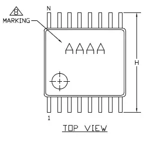

If you dig a little deeper on the Maxim website, there's a package drawing for this part.
Pin 1 is clearly indicated.
MAXIM TSSOP
Note 8 says: "MARKING IS FOR PACKAGE ORIENTATION REFERENCE ONLY", which means AAAA is boilerplate text.
Essentially, if you can read AAAA, pin 1 is lower-left.

Chips are marked various ways, but the conventions are pretty universal. In other words, if you find one of these on a unknown chip you can rely on knowing which is pin 1. The conventions are:
  • Pins are always numbered around a chip counter-clockwise when looking at the top. This comes from the old tube days where pins were numbered clockwise looking at the bottom of the tube, as you would when wiring up a socket. Just like with the old tubes, there is something on the package which marks one place a bit more special than the others. This is where you start counting from 1 going around the chip.
  • A dot can be in the pin 1 corner.
  • A notch can be at the pin 1 end. Actually thinking back to the tube convention, the notch is really showing you where the start/stop gap in numbering is when going around the chip. This is totally consistent with tube pin numbering.
  • The pin 1 corner can be shaved off. This is common with packages that have pins coming out all 4 sides.
  • A band or other marking shows the pin 1 gap. This is what you have in the picture above. In your picture, pin 1 is therefore in the lower left corner with numbers proceeding to the right accross the bottom row, then from right to left along the top row. Again, think of going around counter-clockwise when viewed from the top starting at some uniquely marked gap. In your example, pin 10 is the in the lower right corner, pin 11 at upper right, and pin 20 at upper left.

The white strip on the left side of the picture looks like a similar indicator to the notch in most ICs, hence pin 1 would be on the bottom-left of the supplied picture.

All common TSSOP ICs seem to have pin 1 at lower left when IC is seen from above and text is correct orientation. Then pins count left to right, then on above row they count right to left, like anticlockwise numbering.
This is seemingly also true for all other dual-row ICs as @MartinThompson has pointed out.
