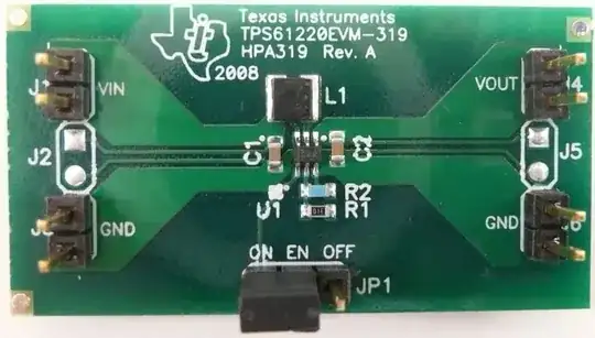

There is a line going from pin 1 to pin 6 on the package.

  • @alan Your right, that line is not in the datasheet, but you can see on the image that it is next to pin 1 and 6. – HandyHowie Sep 21 '16 at 12:40
