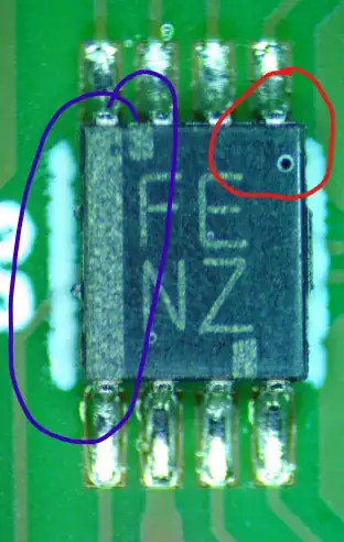

I have a component in a VSSOP (TXS0102DCU), which I am uncertain of the orientation. There is both a bar and a dot. The datasheet just specifies pin 1 marking area, but this does not seem clear to me.
Going by the answer to a similar question (How do I identify Pin 1 on a chip with no corner mark), I would have guessed blue is the right marking. This is based on the orientation of the text. Is this correct?

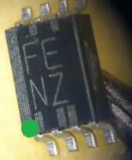

Pin 1 (green circle) as shown below:
