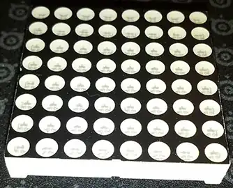

This chart is supposed to correspond to this 8x8 LED, 12x12pin LED matrix:

  • The physical led matrix has 12 pins on top, 12 pins on the bottom.
  • The diagram shows 16 pins on top, 8 pins on the left.
How am I supposed to make sense of this? I highly appreciate an actual answer as opposed to someone pointing to arbitrary articles because reading articles on this is all I've done the past two evenings.

The first picture you posted is called a schematic diagram and shows how the component is wired logically. It doesn't necessarily show how the pins are physically arranged. It does show where the LEDs are, though.
To make out how the pins are arranged, you need to look at the pin numbers, locate pin 1 and count from there. Be careful when counting from pin 12 to 13 - you must follow a clockwise direction, that is, pin 13 is the one one the upper-left side of your 2nd picture. Pin 24 is the one on the upper-right corner.
So, if you want to use just one color, choose red or green symbol from the legend (green has the LED symbol filled) and pick the pins coming in and out of those LEDs only.
In either case (picking red or green), you'll always have to wire pins 1, 2, 3, 4, 21, 22, 23 and 24 to the positive terminal of your power supply. These are the LED common cathodes. They are called common because they are shared among each pair of red and green LEDs. If you choose to use the red LEDs, you'll also have to wire pins 13 through 20 to your negative supply. On the other hand, if you pick green, you'll wire pins 5 through 12. These are the LED anodes.
In other words, to light up the red LED on the lower-left corner, you must apply voltage (with limited current), to pins 1 (+) and 20 (-). To light up the green LED at the same position, you must apply voltage to pins 1 (+) and 5 (-).

The numbers in the circles on the top diagram (schematic) are pin numbers. Pins are numbered starting at one, and go counter-clockwise when looking from the LED side.
See How do I identify Pin 1 on a chip with no corner mark if you feel you need more help
If you connect any row pin (left hand side pin number) to a positive voltage, say 5V from your Arduino, and then any column (top pin numbers) via a 1k resistor to ground (GND), a LED will come on.
Use that to figure out what is connected to where. It is pretty quick if you gently ease the LED into a breadboard. Mark on the edge of the breadboard (with a Sharpie, or tape) pin 1, 12, 13 and 24, to make it easier to track what is happening.
You will be able to see which are Red or Green.
