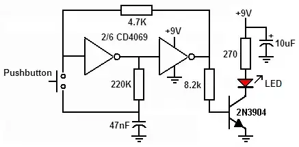

  • I like the solution with 2 inverters. Just wondering what would be required to enable this to switch 30V @ 1A? – stevenrcfox Apr 01 '12 at 21:33
  • @Overlow: Replace the output transistor with a power transistor or relay – endolith Apr 04 '12 at 00:19

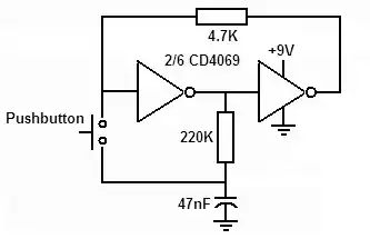

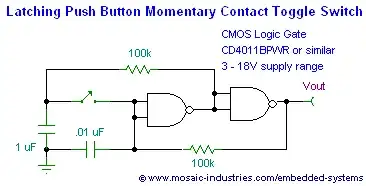

Here's another alternative with two inverters and debouncing:
Two inverters
For logic output, only the two inverters, RC, and feedback resistor are needed:
NC7WZ14 is $0.06 with 2 inverters, small 6-pin package, and Schmitt trigger inputs, though I think this circuit doesn't even need Schmitt inputs because of the RC. Also it can drive 24 mA, so you could connect the LED directly to it if you're using an LED for whatever reason.
Also shown here and here as a toggle touch switch.
I think the feedback resistor has to be much smaller than the center resistor to prevent it from oscillating if you hold down the button, because the low-impedance connection to the output will prevent the capacitor from charging to the middle voltage until you let go.
Variants are described at Press ON - Press OFF soft latching circuits:
AND gate variant
endolith
  • 28,734
  • 24
  • 119
  • 184
  • When this is first powered on, will it start up with the output on, off or random? Just inspecting the circuit, I'm guessing it will power up with the output on. – Craig McQueen Apr 16 '17 at 03:51
  • @CraigMcQueen When first powered on, the capacitor will have 0 V across it. So the first circuit will start in the ON position. Connect the capacitor to the supply instead of ground, and it will start in the OFF position. – endolith Apr 16 '17 at 03:53
  • @CraigMcQueen Actually is that guaranteed? I'm not sure. The inverter's low output impedance will dominate over the 220k resistor, so it might start in a random state. – endolith Apr 16 '17 at 03:56
  • @CraigMcQueen The last circuit shown will start with 0.01 μF capacitor 0 V, so Vout will be 0. – endolith Apr 16 '17 at 03:57
  • @endolith Where in the last image is the VCC connected? I see ground and Vout. – Mike Jun 17 '17 at 10:51
  • @Mike The logic gates have VCC and GND connections that aren't shown – endolith Jun 17 '17 at 11:03

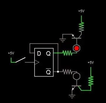

One possible method:
Use an RC to debounce the switch
RC network connected to momentary switch to debounce
and then feed it into a D flip-flop with the output feeding back to the input to implement a T flip flop.
D flip-flop configured as toggle flip-flop
The D flip-flop needs to be positive edge-triggered only, and needs an inverted output.
  • The 8-pin NC7SZ74 should work, is very small, and costs $0.12 in quantity.
  • The 74HC74 is a dual D flip-flop with 14 pins for $0.05.
Are there any issues with this? The switch would need to be held down for a short period of time for the rise time to trigger the clock input, which is probably good. If you hold down the button, it will only trigger once, which is good. Is there a better way to debounce in the feedback loop or something instead?

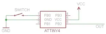

Or you could do it with a single tiny 6-pin microcontroller and no other components. It might cost a tiny bit more, but it's simpler and takes up less space. Debouncing a switch in software is simple, then it's just a manner of storing a boolean if the output should be high or low. The smallest version of this mcu comes in a 2mm x 2mm surface mount package. In large quantities it might be $0.50.
toggle schematic
Glorfindel
  • 1,245
  • 15
  • 20
davr
  • 6,812
  • 26
  • 37
  • +1 - But I believe that part only comes in SMT though. – J. Polfer Aug 18 '10 at 13:00
    Yeah but even the cheapest microcontroller is going to cost more than simple digital logic. It's a pretty complex system to do a simple task, and you're opening yourself up to the world of software bugs. Also, does it increase production costs to be programming every micro? – endolith Aug 18 '10 at 13:19
  • So you'd use the internal pull-up resistor on PB0 set up as a digital input and then ground it to trigger it, right? You shouldn't need a resistor in series with the switch that way. – endolith Aug 18 '10 at 13:56
    @TokenMacGuy No current should flow from PB0 to GND, since PB0 would be an input, not an output. @endolith correct, using the internal pull-up means no need for external pull-up. (In addition, the pull-up is not in series with the switch, with either an internal or external pull-up). @sheepsimulator coming in SMT is only a problem for the hobbyist. In that case, an extra dollar or two wouldn't be a problem, and you can easily step up to the 8-pin DIP ATtiny25. – davr Aug 19 '10 at 00:46
  • @endolith It depends on the application I guess. There are always tradeoffs. Everything but the very most basic of device has some sort of logic in it. Saying you open yourself up to the world of software bugs isn't that big of a deal...without the mcu you open yourself up to hardware bugs, since you are constructing some sort of digital/analog circuit to perform logic. – davr Aug 19 '10 at 00:50
  • The PIC10F200 is comparable, it comes in a SOT23-6 package, but is much cheaper than the AVR. – Federico Russo Sep 13 '13 at 07:23

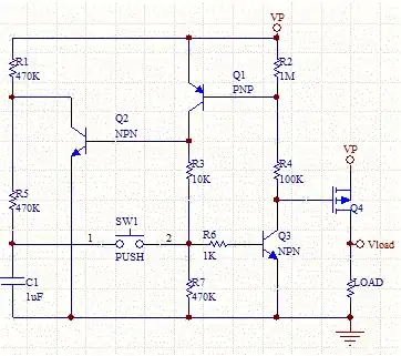

This circuit (also described here) is very cheap, but is more complex and takes up some space with all the components. If transistors are like $0.02 in large quantities, it would be maybe $0.10 total?
3-transistor latching switch
endolith
  • 28,734
  • 24
  • 119
  • 184
  • $0.02...maybe if you buy 27,000 of them like here: http://search.digikey.com/scripts/DkSearch/dksus.dll?Detail&name=MMBT4124-FDITR-ND – davr Aug 18 '10 at 05:21
    $0.03 is an awful lot like $0.02 in small quantities... – SingleNegationElimination Aug 18 '10 at 13:24
  • 3904s for 1.4 cents: http://www.newark.com/on-semiconductor/mmbt3904lt1g/bipolar-transistor-npn-40v-sot/dp/83K0942 At high quantities, capacitors are like 1 cent, and resistors are like 1/10th of a cent. – endolith Aug 18 '10 at 14:02
    It looks as though transistor Q2 needs a resistor on the base, to limit the current flowing through the base. – Craig McQueen Apr 25 '17 at 23:55
  • Instead of adding a resistor, transistor Q2 and R1 can be removed. Connect the high end of R5 to the collector of Q3 and it should work pretty much the same. The time constant will be a bit different because of the high value of R2. So either adjust R2 or adjust C1. – gnuarm Feb 23 '21 at 03:15
  • @gnuarm That sounds like a separate answer... – endolith Feb 24 '21 at 12:35

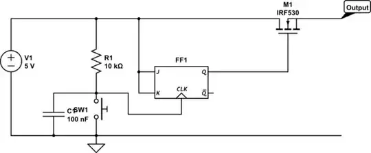

Make a T flip-Flop by shorting the inputs of a positive edge-triggered j-k flipflop and connect the pushbutton output to the clock input of j-k flip flop.
schematic
Prayuktibid
  • 155
  • With the capacitor on the clock input this circuit is suseptable to double clocking on noise. Some devices have Schmitt trigger inputs on the clock, if not one should be added as a buffer between the cap and the clock input. An alternative is to use a D FF with the Qnot driving the D input with an RC longer than the button debounce. Then it won't matter how many times the input is clocked, the output won't change after the first one until the RC times out. However... buttons bounce on release as well as press. So... it's complicated. – gnuarm Feb 25 '21 at 13:25

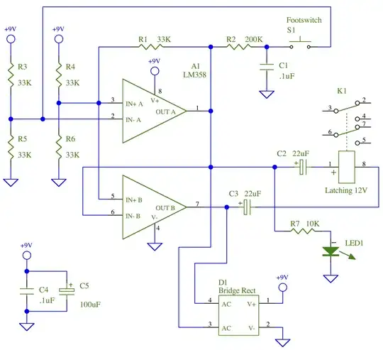

Not sure exactly what the end goal is but I thought I'd put this out there:
This is a great little circuit I like to use to drive bistable relays. It's pretty cheap to build as well.
Pressing the momentary switch toggles the state of the relay and the LED. It's not really picky about how long you hold down the button. Since the relay is latching, it won't draw much current most of the time.
In this configuration, the LED will turn on when the relay is in its set condition and off when the relay is reset. You can also connect R7 to the + terminal of C3 to make the LED turn on when the relay is reset instead.
I like to use this in guitar effects so I can bypass or engage the device with a momentary footswitch. Of course a 3PDT switch would do the same thing on its own, but the switching is quieter this way (no big pop) and momentary soft-touch footswitches feel much nicer than the big 3PDT ones.
Hope this helps.
