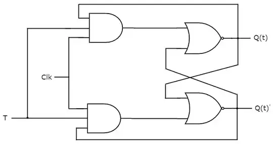

I think you are describing either a Latching Switch Push button compared to two momentary switches?
Or you could be describing a Toggle Flip Flop circuit connected to a momentary switch?
They look something like this, they don't need the clock signal and can just work with the feedback and Toggle inputs.
If you have a microcontroller you can write this functionality in software and make any trigger input work like this.
