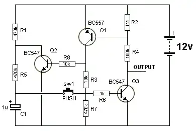

Im a very beginner to electronics. Im trying to build a simple circuit with push on off latch button. Means if we push the switch first the led should on, again push it should off.
So when in search I got a circuit as shown below. But its little different from my requirement. My requirement is like there are 5 switches. When ever a switch presses the corresponding led should toggle. Also the worry is if we hold the switch to the on state for some seconds, does it toggles quickly. if so how can we avoid that. Like even if we hold the switch it only should toggle one time
So if first switch presses, it should turn its corresponding led if the led is off. Same way when the second, second led should on (if its off). 3rd 4th 5th are same. So when 1st again press the first led should go off. Requesting kind help.

Figure 1. "Latching a pushbutton". Source: Talking Electronics.
  • When the circuit is turned on, capacitor C1 charges via the two 470k resistors. When the switch is pressed, the voltage on C1 is passed to Q3 to turn it on. This turns on Q1 and the voltage developed across R7 will keep Q1 turned on when the button is released.
  • Q2 is also turned on during this time and it discharges the capacitor.
  • When the switch is pressed again, the capacitor is in a discharged state and this zero voltage will be passed to Q3 turn it off. This turns off Q1 and Q2 and the capacitor begins to charge again to repeat the cycle.

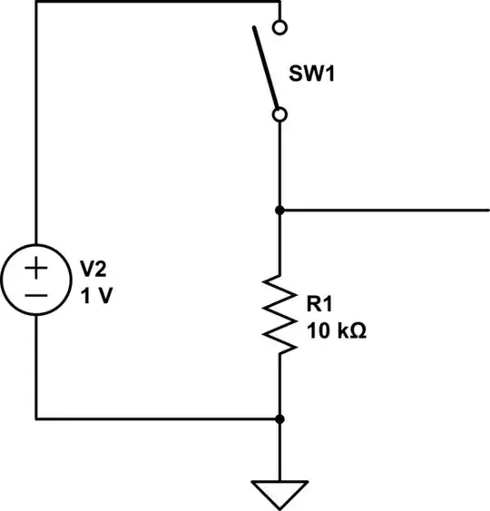

What you need are 5 bi-stable switches, something like the T flip-flop (well, not exactly but similar).
You can do that with either:
  • a microcontroller, as RedGrittiBrick pointed out
  • 5 T flip-flops with their input at logic '1' and your switches commuting their CLK
  • any other bi-stable logic circuit
Note that, in order to create a logic input from a switch, you need a pull-up and pull-down circuit, for instance using a resistor as pull-down and the switch as pull-up:
schematic

  • For TTL or CMOS, you're usually better off with a pull-up resistor and a switch going to ground. You usually want a capacitor across the switch, for a cheap debounce circuit. For ECL, use a level translator. – John R. Strohm Jul 19 '17 at 18:11
  • @JohnR.Strohm thank you, you're right. Though I think that in order to understand the principle using Falstad, the simplest circuit could help too – clabacchio Jul 20 '17 at 06:41
