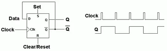

@Andyaka Thanks for the tip! This seems to get me so close to what I need, with the exception of requiring two switches to control it. The functionality I need is a single momentary switch latching the relay on, then latching it off again on the next press. I imagine I'm missing something fairly obvious in making this happen, so will keep playing, but felt it couldn't hurt to ask for an extra prod in the right direction please?
OK, to make this work from a single switch, tie the D input to the inverted output of the D type flip-flop (Q bar) instead of tying it to logic 1. Now, each time the switch is pressed (i.e. a single press puts clock high and then returns it low when released), the output toggles state and remains latched until the next transition on clock: -

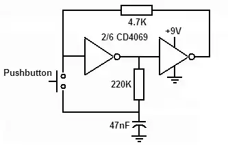

If you were to build it in hardware then a good trick is to incorporate contact debounce like this: -
Taken from this answer from 2013.

  • That's absolutely perfect! Wow! I think I could have played with this for weeks without getting something that neat in execution! Thanks so much! – J. Carter Jun 26 '19 at 13:39
  • Small note for anyone finding this as a potential solution to the problem, it works really well in some circuit simulators (Falstad, for instance) for a single latching relay, but doesn't work in others (e.g. Everycircuit/Multisim), and exposes what I think is a bug in Falstad in that if you try to control the clock with a relay (or another D flip flop) it will register a signal even when the relay/flip flop is open. So close :/ – J. Carter Jun 27 '19 at 13:20
  • Of course it will work in all simulators. It’s a standard technique. If you couldn’t get it to work then that might be an implementation problem. – Andy aka Jun 28 '19 at 15:52
  • As noted, it does work, but fails to read anything but direct inputs in Falstad (the only simulator I've found a D flip-flop that registers the Q bar -> D connection) making it ineffective as a solution. Here's the simplest way I can demonstrate this... https://ibb.co/m6brxhf The input is registered despite that the relay is open and no connection is made. – J. Carter Jul 01 '19 at 09:43
  • The link doesn't show anything relevant in my browser and your words above don't make sense to me. – Andy aka Jul 01 '19 at 11:05
  • Assuming you can see the picture (if not, I'm not sure how else to show you it), the Green wires indicate wires that are in some way 'active'. In this case, you'll note the switch powering the relay is open, so the relay is also open. It should therefore not send a signal to the D flip-flop, but the green wire indicates that it does. Thus you can't toggle the D flip-flop electronically, as it registers all inputs except a manual switch as 'on' even when they are not. – J. Carter Jul 01 '19 at 13:10
  • Have you ever heard of using a pull-down resistor on a logic input when being activated by a switch or contact? Yes, I can see the picture now but your circuit implementation is flawed because the simulator (although I've never used Falstad) will likely "store" the initial voltage from the closed switch for the rest of time - it stores it as charge on the input capacitance and, of course, a pull-down (or discharge) resistor is needed to make it work properly (as you would do so in real life on a real circuit). – Andy aka Jul 01 '19 at 15:09

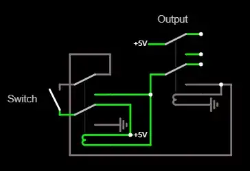

As an alternate solution, lots of people suggested creating a sub-circuit to 'latch' the relay. There was a lot of head-scratching in this, and it's far from neat/uses a lot of resources (in Falstad, at least), but in case it's of use to anyone finding this thread, here's a latching relay setup.
It requires two double pole relays; the first for logic, and the second to use one pole as part of the logic and the other as the actual toggle. So in terms of treating this as a single 'latching relay', the labelled Switch is your input signal (and can be replaced with a single pole relay if this needs to be electrically triggered), and the secondary pole of the labelled Output is what is actually toggled backwards and forwards with each press of the switch.
Latching Relay with Non-latching Relays
J. Carter
  • 85
  • This circuit won’t work in reality because it relies on putting two relay coils in series for it to work. A proper simulation tool that had decent models for parts would also fail this circuit. I might suggest that you change the decision to accept your own answer because it’s clearly the poorer answer for you and anyone reading it. – Andy aka Jun 28 '19 at 15:56
  • @Andyaka I can't see how - your answer doesn't work in the simulators I have access to, whereas this answer works in all of them. The idea here is not to create a working latching relay, but to provide the functionality in the simulator (since no one has been able to suggest a simulator that includes latching relays). The D flip-flop does not work. This does. – J. Carter Jul 01 '19 at 09:46
  • Then you are incorrectly implementing the flip flop circuit or breaking a rule such as not having a pull-up or pull-down resistor. Nobody will use this composite relay circuit for the reason I have mentioned and, for other reasons, they will use a flip-flop. – Andy aka Jul 01 '19 at 15:10
