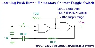

I found this is one of the answers: Toggle Switch Which is from here
I have 4011s on hand so this is a great solution.

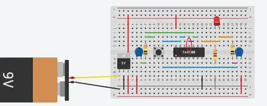

I built it in a simulator on Tinkercad My simulation My parts list: 1 5V Regulator [LM7805],
1 9V Battery,
1 Quad NAND gate [74HC00] (I'll sub a 4011 in the final build),
2 100 kohm Resistor,
1 Red LED,
1 470 ohm Resistor [LED to ground],
1 Pushbutton,
1 1 uF Capacitor [left],
1 0.01 uF Capacitor [right],
Here is the diagram for the 74HC00:
It's a 5v circuit unless the capacitors are changing that so the chip should take it.
The problem that I'm having is that the circled connection is back-feeding 57.3mA when the pin is only rated for 25mA. This also puts the total current throughput at 63.3mA when the max is 50mA. On the diagram this connection is the output of the first [left] nand.

Your only fault was not knowing the Vss range for the 74HCxx family is 2 to 6V above which the CMOS goes into excessive cross-conduction mode failure.
Here is a link to see how prefix affects Supply voltage range options.
Here is a link to see various ways of making a momentary switch toggle an output. Here are a bunch more with some irrelevant images.
A 2 input NAND with inputs shorted together is just an inverter.
Generally it's a bad idea to leave CMOS inputs floating so unused inputs are usually tied to 0 or V+. (ESD issue) Each part number has a datasheet. Never assume until you have them memorized. The oldest was CD4xxx then 74HCxxx then 74AHCxxx etc each going to different supply ranges and speeds.

The 74HC00 is rated for operating voltage up to 6 V only. There is an excellent chance the chip has failed.
http://www.futurlec.com/74HC/74HC00.shtml
Without pin numbers on the schematic it is impossible to diagnose whatever else might be going on.
