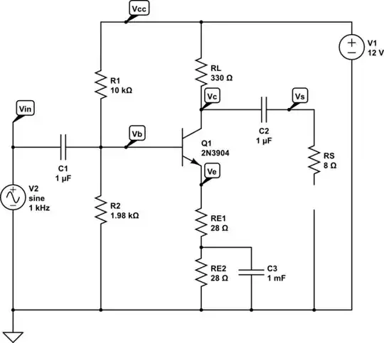

I designed this class A amplifier. It's my first attempt at designing an amplifier with transistors. My objective is to build a guitar amplifier with tubes, but I figured that building an amp with BJTs and a low-voltage power supply first will enable me to understand what's going on before I attempt anything more complicated.
I want to drive an 8-ohm speaker. The problem, of course, is that if I connect RS, the speaker, suddenly the AC signal sees basically 8 ohms to ground and can't develop any voltage at the Q1 collector.
I think that the proper way to do this is to connect the Q1 collector to the base of another transistor, Q2, configured as an emitter follower, and drive the speaker from the emitter of Q2.
But what I'd like to understand is, what is the limiting factor that prevents me from driving the speaker from Q1? I have a fuzzy understanding that I need Q1 to provide voltage amplification and then an emitter follower to provide the current to drive the speaker, but I don't understand why I can't get both in one place, since all the power is ultimately coming from the same power supply. Is there a way to enable this circuit to drive an 8-ohm speaker without adding a second transistor?

    Let's say the output resistance of your amplifier is 300 ohms. And that it outputs Vmax volts. How many volts will you be able to see on a 8 ohms load? (Do you see a voltage divider realized with Rload and Rout?). Well the reason you can't do it with one stage is that: the CE (with emitter degeneration) has a good amplification but also a medium sized Rout. So, if your load does not match that Rout you need something else to match it. – Sredni Vashtar Apr 14 '18 at 22:43
  • The way this was done with vacuum tubes (if class-A) was to swing the plate (or cathode, sometimes) voltage around over a very large voltage range and to feed that (several different ways) through a transformer that dropped the high voltage swing while increasing the current compliance. In effect, the transformer matched the speaker impedance to the tube circuit impedance (which is often in the vicinity of $6:\text{k}\Omega$.) Your BJT collector can pull down. But it can't "pull up." The only thing pulling up is $R_L$. Not going to work. – jonk Apr 14 '18 at 22:52
  • (Just noticed you called RL what I call Rc - which is basically Rout - and Rs what I call RLoad). How much can you lower your RL (my Rout) and your Re to keep the gain? – Sredni Vashtar Apr 14 '18 at 22:52
  • How did you come up with this design in the first place without considering the effect of the load impedance? If you need a complete course in common-emitter amplifier design, this question is far too broad for this site. – Dave Tweed Apr 14 '18 at 22:57
  • Why don't you just put your schematics into LTspice, and look at all waveforms (voltages and currents) by yourself? – Ale..chenski Apr 14 '18 at 23:02
  • As with any Class A Amp. Your load impedance must be > Rc to prevent starving the Ic current. So you cannot drive 8 with 330 Ohms. Remember the collector is a current source. transistor radios with only 7 BJTs in total would use a step down transformer to isolate DC from speaker and transform the impedance. – Tony Stewart EE75 Apr 14 '18 at 23:38

  • You have a voltage divider with 330 ohms and 8 ohms. The voltage across both, combined, is 12 volts. Calculate the voltage across the 8 ohm resistor. – user253751 Apr 16 '18 at 03:28
  • After studying this for a long time, I think that the answer is this: Driving a 4-ohm speaker requires something like 1000X the power that an electric guitar can generate, and getting 1000X amplification with one BJT is impossible. – Willis Blackburn May 14 '18 at 01:11
  • It can be done if you provide enough collector current. There are a number of amateur class A amplifies working on this principle without a buffer relying only on a feedback to provide low output impedance. Usually they employ a constant current source as a load and a shunt (collector to base) feedback. – e_asphyx Jul 24 '22 at 11:52
It can be done. Remove Rs and C2. Let your speaker be RL. RE1 and RE2 should be smaller, because they seriously limit the voltage swing over RL.
Prepare to waste continuously about 9W, half of it in the speaker and possible RE and the other half in Q1 if you want the maximum theoretical audio output power. I bet 2N3904 doesn't stand one second, you need something stronger and well cooled.

12V supply allows about 6V peak voltage swing. The DC resistance of the 8 Ohm speaker is near 8 Ohms. Let's assume it is 7 Ohm. Some RE is useful for linearity and thermal stability. Let's have one RE, only 1 Ohm. Now we have 6VDC over 8 Ohms.That means current =750mA. That means 9W DC power outtake from 12V in idle state.
The speaker should stand 750mA DC if it can handle say 10Watts.
Constructions like this were used by hobbyists in the old days (say 1960 - 1970) because they could get a couple of watts acceptable audio signal AC power without complex push-pull stages and the continuous power loss wasn't a problem if one used 12V car battery as his power supply. A 20cm x 20cm x 4mm aluminium heatsink was able to keep the transistor cool enough. The price of the transistors and other components is today so low that it's useless to avoid the normal push-pull output stage. Even class A amp works best as push-pull.
One trick: Put a massive inductor in parallel with the speaker. The DC current does not go through the speaker and you can multiple the output AC power, because the voltage swing can be more than 12Vpp. The inductor should be about 50 mH or more and it's iron core should be large enough to stand the DC magnetization without getting saturated.
In theory you can add a DC saturation compensating winding to the same inductor core if you drive the compensating DC through another speaker to pick the outputted AC. Otherwise it's a shorted transformer.
Another way to compensate is to add a permanent magnet to the magnetic circuit.
  • It occurred to me that I could put the speaker in place of RL, but in order to drop 6V across it, I'd need 750mA of current, which would fry the transistor. Did you get to 9W as 6V*0.75A? – Willis Blackburn Apr 15 '18 at 00:48

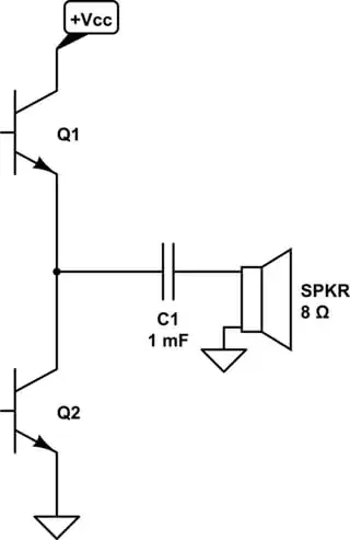

Class-A amplifier design overview
After watching those two videos, Single transistor, 1W and Adventures in a one transistor audio amplifier, I had to illustrate a slightly more sane design approach. To start out, here's the basic idea about how to drive a speaker (without having to find and use a flux-limiting, gapped, audio transformer -- which you will definitely need if you plan to run DC current through the primary):
schematic
\$Q_1\$ is an emitter follower and it will be able to source current into the speaker. \$Q_2\$ is a common emitter and it will be able to sink current from the load. Together, they can do a fair job of sinking and sourcing current.

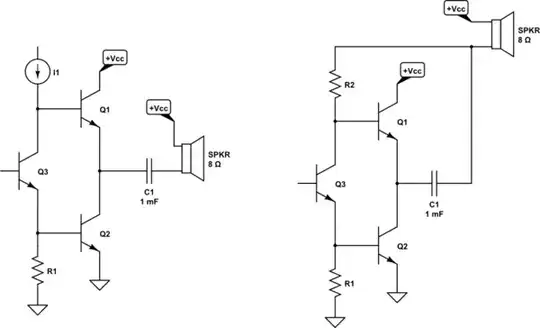

A 3rd BJT provides the voltage difference required:
schematic
simulate this circuit
Note that I've shown two schematics.
On the left, I've connected the speaker slightly differently (which would also work fine) in order to help segue into the transition on the right. I've also added the 3rd BJT that's needed. On the left is also a current source above \$Q_3\$ and a small resistor to sink a little excess current.
On the right, I've bootstrapped the design to provide the current source indicated on the left. Capacitor \$C_1\$ will develop a voltage across it that remains fairly fixed. Also, \$Q_1\$'s \$V_\text{BE}\$ will have a relatively fixed voltage across it, too. As a consequence, resistor \$R_2\$ will have a nearly fixed voltage across it. So it will form the equivalent of a constant current source. Just what we needed.

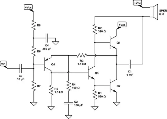

\$C_4\$ gives me an AC ground for a balanced midpoint. The only remaining thing is to compute \$R_8=\frac{12\:\text{V}-3.8\:\text{V}}{80\:\mu\text{A}}-R_6=55.5\:\text{k}\Omega\$. So \$R_8=56\:\text{k}\Omega\$.
Here's the final schematic:
schematic
That's a class-A amplifier, educational-level not professional.
(Update: I've added a necessary compensation pole capacitor, \$C_5\$, to the above circuit with a nominal value I think will be about right. It was important in order to roll off the high frequencies. So it's included now.)
I promised to add a class-AB. There are some tweaks needed to deal with discrete BJTs that haven't been included, nor discussions about them. So again, this is more of an educational level -- though if you built it I expect you'd still get passable results from it.
schematic
It includes temperature and device \$\beta\$ and \$V_\text{CE}\$ matching compensation for the diff-amp and mirrors and a few other areas, as well. Adjustments available for the VBE multiplier so that the quiescent current can be set up where you want it and so that the parabolic thermal response can be tweaked, as well.
