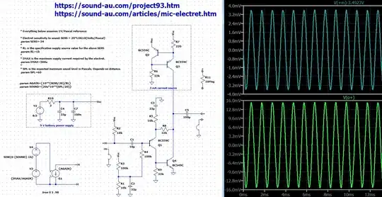

I've redrawn it in a way I prefer. And I've replaced his output capacitors as this will be feeding into the next stage and I just wanted to test it. Click on the image to make it larger and more readable:
I've also included an electret simulation of my own in the lower left corner, for testing purposes. (And the obvious \$9\:\text{V}\$ battery source simulation, as well.)
The top graph shows the loaded microphone output, which is about \$2.5\:{\text{mV}_\text{RMS}}\$. Unloaded, this would be closer to \$2.8\:{\text{mV}_\text{RMS}}\$. But the amplifier will load it down a little.
The bottom graph shows the unloaded output of the amplifier stage. (I used a \$10\:\text{M}\Omega\$ resistor, which is essentially no load.) This is about \$10.6\:{\text{mV}_\text{RMS}}\$. So the gain is about \$+12.5\:\text{dB}\$.
