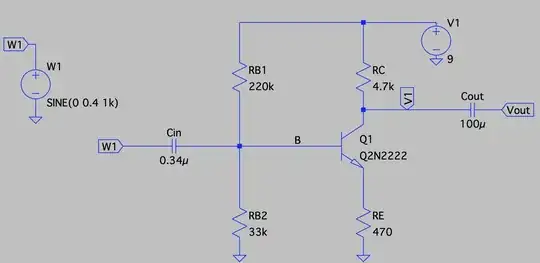

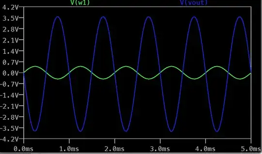

I am trying to design an amplifier for a 1 W 8 ohm speaker for educational purposes. The idea is to start from a common emitter amplifier to amplify voltage and then add a common collector (emitter follower) amplifier to amplify power and deal with impedance matching. I am a mechanical engineer and I am just learning about electronics so please bear with me.
The first step seems to work fine. I have sized the various components following this tutorial. I assumed a required gain of -10.
Enter image description here

  1. Can I actually build an (educational) amplifier with this approach?
  2. Do I need to increase the gain of the first stage and change the transistor?
I could buy a pre-designed kit of course, but what's the fun with that...

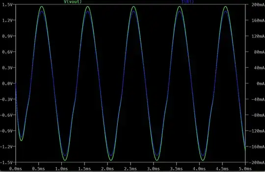

Updated circuit 1
Thanks to the suggestions I have updated the circuit replacing the Q2 transistor with a Darlington pair and reducing the common collector emitter resistance to 2 ohm. Maybe it is unrealistic, but I assume I can get it by using multiple resistances in parallel.
And a much better outcome!!
