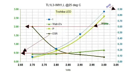

Example:
\$V_f= V_{th} + I_f*ESR ~~~~~ \$
- Vth is knee of curve like Zener threshold ( LED, Ge, Si etc)
Verify my assertions
Toshiba LED TL1-L3-xxx specs
  • 2.85V (typ) @ 350mA, 1A max (pulse) so measure ESR > 0.1A
  • Pd (typ) = 2.85 * 350mA = 1W
  • ( my rule) ESR = k/Pd for k= 0.5 (good) to 1 (fair)
From spreadsheet above ( generated from datasheet) see how ESR ( dark green) flattens out above Vf = 2.85V
  • ESR @ If
    • (left Y-axis vs right Y-axis)
 1.5 Ω @ 100mA
 1.0 Ω @ 175mA
 0.5 Ω @ 350 mA ( 2.85V )
 0.25Ω @ 1000 mA  ( absolute max)
enter image description here Since above means ESR k factor = 0.5 this is an excellent efficient LED ( more than just good) Low power LEDs like 5mm tend to have k=1 e.g. 65mW , ESR = 16 Ω . Generally the better the product quality and bigger the size, lower k is better, a useful Figure of Merit (FoM). and remember the tolerance on specs is wide, but your results depend on supplier.

Diodes are inherently logarithmic over 4 decades when ideal. This is a large power diode so the linear bulk resistance is quite small compare with the logarithmic natural response.
I have often talked about how the incremental linear resistance of diodes follows the inverse Pd rating +/-25% for k=0.5 to 1 for ESR=k/Pd. This is my own discovery , not taught yet consistent with most diodes and transistors. although this part has no Pd rating it’s 5A@1.1~1.7 @60’C implies an avg. of 7W or an ESR of 0.07 to 0.14 ohms or an avg. of 0.1V rise per Amp. This gives a ballpark estimate of the curve in the 1 to 10A range above which becomes linear as shown by the curve in the log-lin graph of the fig 4 in http://www.eicsemi.com/DataSheet/HER501_8.pdf
But this curve you show is only for narrow pulse where the junction temperature is regulated at a constant 25’C.
But for ESR, it does follow a somewhat linear curve between 10% and 100% of max rated current. Below this it the incremental R is logarithmic.
So yes and no are your answers. It depends on ESR.

Diodes are non-linear (whether they emit light or not).
"Non-linear" means they do not follow Ohm's Law in the usual fashion as do resistors, heaters, long wires, etc.
 E=IR              E (volts) = I (amps) x R (ohms).
At any instant there's a value for E and I, so an effective R can be computed.
But Ohm's Law gives a sense that R stays constant if E or I changes: if E doubles I must double too. That is not true for non-linear things like diodes.
