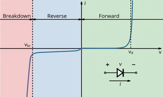

The calculation you're using is an approximation, but it's a good one. It assumes that the voltage across an LED is constant, no matter what the current is. This is not actually true, but it's close, because LEDs are diodes, and thus exhibit a characteristic diode IV curve (ignore reverse voltage for now):
Notice that as the voltage increases, the current increases very quickly. For reasonable currents, from the minimum operating current to the maximum current before the LED breaks, the voltage will remain pretty constant, +/-10%. If you have a constant voltage power supply, that means that the voltage across your resistor will also be constant, no matter the current, due to kirchoffs voltage law:

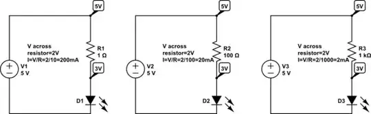

schematic
You can see here that as we change the resistance, the voltage across the LED stays the same, so the voltage across the resistor stays the same. The current increases as we decrease the resistor.

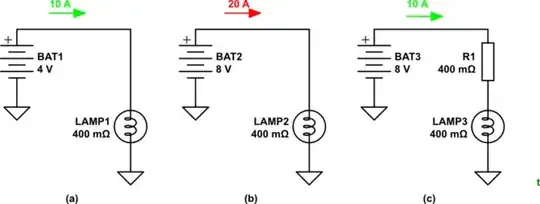

Your turbine understanding is not quite correct. Let's try this:
  • You have a turbine. It will run at maximum speed at 10 L/s. For 10 L/s I need 0.4 bar pressure difference between the input and output. That's about 4 m "head" of water. (10 m = 1 bar = 1 atmosphere.)
  • You have a river and a dam. It is 8 m higher than the outlet. Now your turbine will have 0.8 bar pressure. The flow will be much faster (higher current) and your turbine will run too fast and break up. (The blades will fly off or the rotor imbalance will shake it to pieces.)
  • To solve this we add a valve on the feed to add some resistance to the water and limit the current to 10 L/s. Now the turbine can run at the rated current.
schematic
Figure 1.
(a) The correct battery (head of water) for the lamp (turbine).
(b) Double the head gives double the current. The bulb (turbine) will be destroyed.
(c) R1 limits the current (flow), introduces a voltage (pressure) drop and the lamp (turbine) is run with the correct current (flow).
... and no effect on this tribune [turbine] at all.
That is the idea. The turbine doesn't know anything about the resistance.

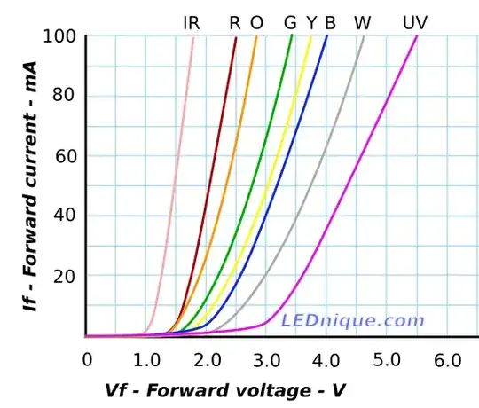

Pushing the analogy a little further, we can also see that further pressure drop will occur due to the constriction of the valve. The more water we push through the valve the more the pressure will drop. This will be added to the initial pressure drop required to open the valve in the first place. The resultant pressure drop graph will look remarkably like one of the I vs V curves below.
Figure 3. Typical IV curves for various colours of LEDs.
I hope that helps. (The LEDnique article is mine.)

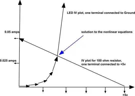

Lets examine the combined I-V curve for LED to Ground, in series with resistor to +5v
schematic
