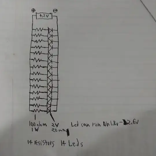

I'm using an 18650 (4.2v unknown mah) to power 14 leds (2v 20ma) in parallel with a 100ohm 1w resistor on each led. Everything has been running fine for 12 hours now with no problem.
My understanding is the resistors should drop voltage from 4.2 to 2v but my volt meter shows no change. Am I understanding resistors right? Any help in explanation would be greatly appreciated.enter image description here
Allow me to clear up your misunderstanding.

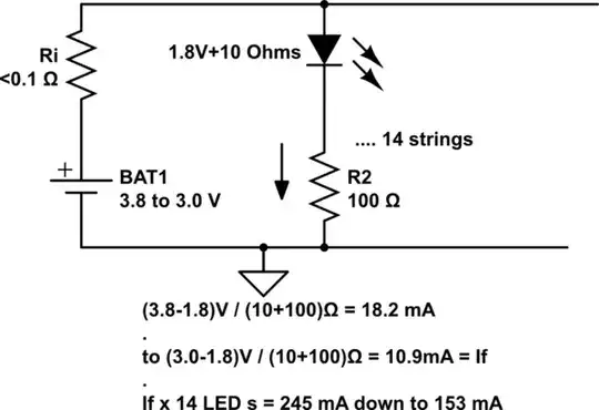

The battery under a light load drops from the charge voltage of 4.2 to 3.8 fairly quickly. (minutes) The current in each LED is always defined by the voltage drop across each R. or I=V/R
I think you would like to measure your unknown battery capacity at a 1C = 20 hour rate. You have chosen 14 LEDs (2v 20ma) which are presumably Red or Yellow high brightness... These act like Zener diodes with a saturation threshold voltage , Vt and an internal resistance , Rs to create a forward voltage Vf=Vt+If*Rs. In addition to this you have your fixed resistor of 100 Ohms.
Due to the decline in battery voltage the light load current will reduce slowly from 3.8 V (100% SoC state of charge) to 3.0V = 0 to 10% SoC. Since battery has <0.1 Ohm Rs, it also rises sharply < 10% SoC which affects Vbat under heavy load more significantly. The Rs (or ESR) rises to 10x the initial level when dead, but you ought to avoid going this low for long life.
schematic
The battery mA capacity can be measured best by recording the V drop across R every hour or every 0.1V drop from ~2V down to ~ >1.2V
The 1C capacity is the number of hours at I=V/R * h where the total h is 20 hours.
With an average load current of (245+153)/2 mA = 199 mA
Thus if 1C Rate is 2600 mAh I expect <10% Soc will occur in 2600mAh/200mA avg in 13 hours.
Or in other words if my assumptions and calculations are correct, mAh capacity = 200mA * hours to drop to 3.0V

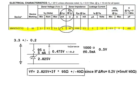

A typical 5mm THT White LED has a Vth of 2.85V and an incremental resistance of about 15 Ohms +/-50% @ 20mA. Now with 5mA the LED will be more stable with a lower Vf ~ 2.9V You can verify on your own. e.g. @ 20mA Vf=2.85+0.15~0.45V. Older LEDs had much higher tolerances on high side, but quality has improved in the last 20 years.
Now compare with an ON Semi 3.3V Zener

  • @ tony-stewart-sunnyskyguy-ee75, the statement “These act like Zener diodes...” isn’t technically valid. LED voltage will vary depending on LED current. Zener diodes hold relatively fixed voltage with varying current (within limits). – Leoman12 Jun 17 '20 at 00:26
  • @Leoman12 Disagree. Go look at ONSemi Zener specs for Zth Ztk which are the incremental resistances at rated threshold and knee and if you compute as I have that Rs or Zt varies exactly alike all diodes and LEDs with inverse variations for zener voltages and power levels. Your statements are incorrect in this view.. If you use a string of LEDs @ 5mA, they will be just as accurate as Zeners. – Tony Stewart EE75 Jun 17 '20 at 03:37
  • @ tony-stewart-sunnyskyguy-ee75 if you take a look at this datasheet (https://www.vishay.com/docs/83010/tlhe510.pdf ) for a LED, you’ll see in either figure 4 or 8 that for a change of 1mA to 20mA, the forward voltage changes from 1.75 to 2V. So under your statement, this is essentially acting like a Zener diode? This can’t be. What I’m saying is incorrect is that a stating an LED acts like a Zener diode.While they may have similarities, the LED isn’t operating in reverse bias as a Zener diode would and it operates under zener effect whereas LED is in forward bias and emits light. – Leoman12 Jun 17 '20 at 19:54
  • @Leoman12 If you use similar currents, it's much better than a Zener. due to knee resistances and 5mm LEDs are bigger than small signal Zeners. If they were the same size, I would expect both around 15 Ohms @ 20mA but small Zeners are rated at 5mA*95Ω=475 mV yet at 0.5mA Zzk=1000Ω – Tony Stewart EE75 Jun 17 '20 at 20:01
  • But if you have different currents, say you use LED at 5mA vs same LED at 20mA, the forward voltage won’t be the same. They may be close though. But then are you saying if I used a Zener at those same currents, the difference in voltage variation for LED will be smaller th an for Zener? – Leoman12 Jun 17 '20 at 20:07
  • Also there must be better zener diodes now? – Leoman12 Jun 17 '20 at 20:09
  • No the Rs is purely a function of power rating and tolerance a quality control. My Rule of Thumb Rs=k/Pmax for k=0.5 to 1 for most diodes of any size. Newer LED diodes have a lower k . – Tony Stewart EE75 Jun 17 '20 at 20:20
  • I used to call Rs = ESR for the bulk resistance https://electronics.stackexchange.com/questions/339055/does-a-diode-really-follow-ohms-law/339088#339088 – Tony Stewart EE75 Jun 17 '20 at 20:23
  • Yes I’ve heard of bulk resistance, but I thought it varies with operating current. – Leoman12 Jun 17 '20 at 20:25
  • Would you say that LED has a better stabilization of voltage than a Zener though? – Leoman12 Jun 17 '20 at 20:27
  • Yes for due availability of LEDs and obsolete Zener technology (low demand) Above 10% rated current the Rs bulk changes slope towards flat.. , that’s the electrode interface where contact area increase with Pmax. See LED link. Zener Rs changes from 1000 to 95 a from 0.5mA to 5mA. (10% to 100%). Just keep LED current at 5mA then 15 Ohms may rise a bit. Consider Rs*If= from 10% to 100% If and Vth as a constant at 25’C – Tony Stewart EE75 Jun 17 '20 at 20:28
  • The knee voltage is always stable and variations in Vf are due to If * Rs & temp coefficient – Tony Stewart EE75 Jun 17 '20 at 20:33
    Interesting. Seems like zeners aren’t what I thought they were. Poor Zener diodes. Thanks for the info. – Leoman12 Jun 17 '20 at 20:34
  • @Leoman12 My Rule Rs=k/Pmax applies to all diodes and transistors alike – Tony Stewart EE75 Jun 17 '20 at 20:35
  • It even applies to batteries ESR= k/V*Ah. Where k depends on quality and chemistry. And also e-Caps – Tony Stewart EE75 Jun 17 '20 at 20:36
  • How would you determine k value? For example, a 2n3904 transistor? It has Pd=625mW. – Leoman12 Jun 17 '20 at 20:43
  • Search ME for answers on. Rce and pn2222A and others – Tony Stewart EE75 Jun 17 '20 at 20:48
  • Once to learn what technology offers Vce(sat)/Ic = Rce and Pmax @ 85’C (not 125’C). You may be surprised to find k = >> 1 on old small signal transistors. And <<1 on patented Diodes Inc low Rce transistors due to electrode design differences and substrate arrangement – Tony Stewart EE75 Jun 17 '20 at 20:50
  • DIODES INC have patented low Rce transistors thus low k or Rce=Vce(sat)/Ic – Tony Stewart EE75 Jun 17 '20 at 20:52
  • For the 2N3904 under-rated at 200mA , Rce = 0.3Vmax/50mA = 6 Ohms 625mW is at Tj=150'C and I use Tj=85'C max thus Pmax = ΔT=65'C/200'C/W = 325mW Max @ 85'C so k= 2 (poor) = Pmax * Rce = 0.35 * 6 Ohms FYI @Leoman12 that's how compute Rs and grade k for bulk resistance. – Tony Stewart EE75 Jun 17 '20 at 21:39

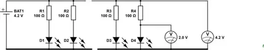

schematic
Figure 1. How to measure battery and LED voltage.
When taking the measurement across an LED measure at the points shown on the left most voltmeter.

  • I've attached the leads of my volt meter to match the schematic and it only drops down to 3v instead of 2v. I've double cheched the resistor with my meter and it's 990hms. – sharky1984 Jan 10 '20 at 18:29
  • What colour are the Leads? – Transistor Jan 10 '20 at 18:45
  • Red to the positive black to the negative – sharky1984 Jan 10 '20 at 19:28
  • Sorry, I didn't spot my auto-correct typo. What colour are the LEDs? – Transistor Jan 10 '20 at 19:30
  • Leds are flickering yellow 2.1v-2.6v around 20ma and operats as low as 1.8v and as high as 3v. – sharky1984 Jan 10 '20 at 19:43
  • What do you mean "flickering yellow"? Are these flashing LEDs? Did you forget to mention this in the question? What is the LED part number? – Transistor Jan 10 '20 at 19:46
  • Sorry, VUPN527. From vetco.net – sharky1984 Jan 10 '20 at 19:55
  • See the update. You never mentioned that these were not normal LEDs. – Transistor Jan 10 '20 at 20:13
  • I was wanting to know why the resistor was not dropping voltage in half by itself and did not realize the led played a role in the output of the resistor. After I posted my question yesterday I ordered a benchtop power supply and I'll be testing resistors and how they affect the performance of the led. Thanks for the help and sorry for the inconvenience. – sharky1984 Jan 10 '20 at 20:43
  • Resistors don't drop voltage unless a current is flowing through them. That's what Ohm discovered and you can see it in his law, V = IR. If I is zero then V (across the resistor) is zero. It's a great hobby. Have fun! Don't forget to accept an answer after a day or two to give others a chance to answer. – Transistor Jan 10 '20 at 21:11
