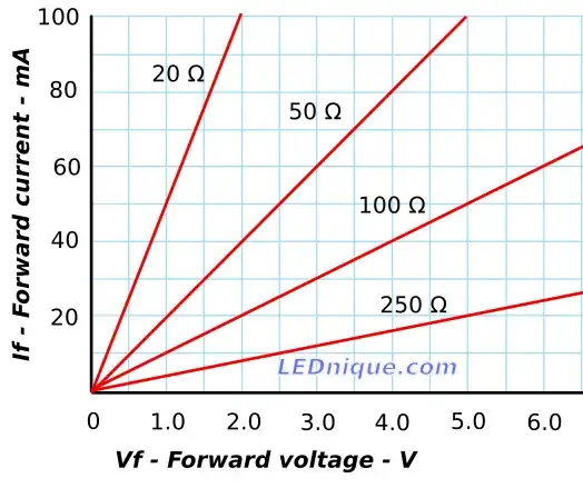

A device’s IV curve – current versus voltage curve – is a graph of the current that will flow in the device as a function of the voltage across it.
Figure 1. IV curves for various resistors. The lines can be extended through 0, 0 to show the relationship at negative voltages and currents.
As Figure shows, the slope of the IV curve for a resistor is a constant - provided temperature effects, etc., are not significant.

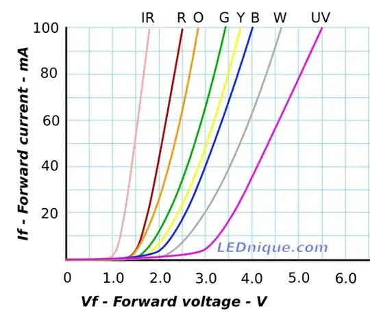

Figure 2. Typical IV curves for various colours of LEDs.
LEDs and diodes in general have a non-linear relationship between current and voltage. They do, however, resist the flow of current and so have resistance. It's just that it changes with the current (or voltage). e.g., The red LED of Figure 2 passes 40 mA at 2.0 V. It's resistance under these conditions is \$ R = \frac {V}{I} = \frac {2}{40m} = 50 \ \Omega \$. At 100 mA the resistance will be \$ R = \frac {V}{I} = \frac {2.5}{100m} = 25 \ \Omega \$.
My response to your question is that all of the definitions are saying the same thing in slightly different ways.

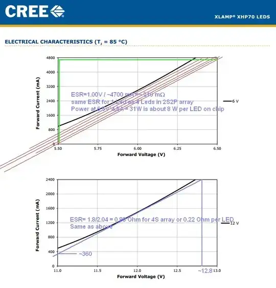

Although Ohm's Law assumes fixed R for a set of conditions, I will show you that it can also be used for every electronic analog part including non-linear , but only if you understand the constraints where the linear value exists on impedance.
I have repeatedly written about the linear bulk resistance of diodes or ESR as a significant process variable in ALL diodes and BJT's. YOU CAN APPLY OHM's LAW on this PARAMETER. \$ESR=\Delta V /\Delta I\$ "but only when saturated" or when R dynamic < ESR. Ohm's Law only is useful for linear fixed R's which includes the bulk R of diodes, DCR of inductors and ESR of Caps. From this parameter, power dissipation limits contribute to the max current of any device.
So the rules for using Ohm's law are fixed linear R but this can be applied to non-linear devices even those with large temperature coefficents like light bulbs for a short period of time. Like estimating the surge current in a tungsten bulb R_cold ~10% R_hot thus Pd surge is 10x steady state. So the constraints for using Ohm's Law on any non-linear device must be well understood and defined and it is assumed you will understand these.(eventually)
This is the only reason why LED's have a wide tolerance on Vf (min-max) @Imax and from the nominal VI curve you can measure the tangent over a limited operating range to estimante this bulk linear resistance.
for more details
This linear characteristic only becomes dominant when the junction is well into saturation and the dynamic resistance is lower than the bulk ( linear) resistance where you can apply Ohm's Law. This is often in the 30% to 100% range of rated current but users may consider where they operate to compute heat rise or voltage source effects on current.
Even though diodes are all logarithmic, they become linear when the dynamic R< ESR.
It is important to realize Ohm's Law for incremental power dissipation applies to "Bulk" resistance to all active and passive devices. e.g. in chokes it is called DCR, in caps it is spec's using % D.F. or ESR , in BJT's we call it rCE (sat.) and in FET's it is defined as RdsOn for Vgs > 3x Vgs(th).
