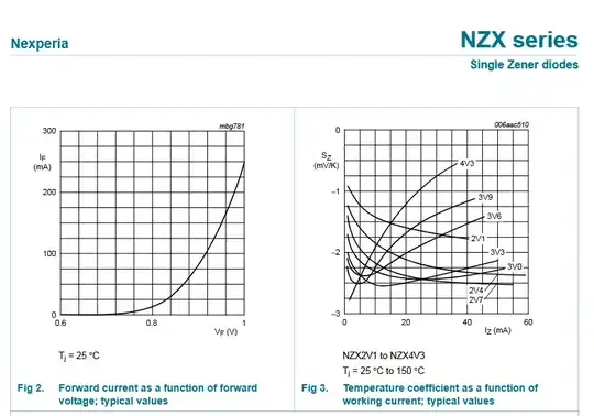

The IV curve of a Zener diode inside the Zener breakdown region looks like the IV curve of its forward bias operation.
Is there a formula which can give the IV relationship in the Zener breakdown? The curve there looks like the forward operation of a normal diode just in reverse?

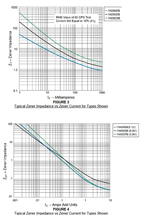

Typically the forward and reverse conduction VI curves might be scaled to a similar exponential relationship but it depends on the doping and depletion layer thickness. Whereas diodes might be frequently pulsed into the linear bulk resistance zone at rated at max power, that same power applied to a Zener would produce very wide voltage tolerances just like hFE tolerances in transistors and Vf tolerances in LED.
Thus Zeners are often rated near 1/4 of the max power in order to provide the necessary voltage tolerance for the Zener such as 10% or 5% or a fixed range. Each company has there own method, but ever since the 'Rotomola' days onsemi uses \$Z_{zt}\$ to define the incremental resistance at a Iz test current while Nexperia uses \$r_{diff}\$ to define the same. This includes some bulk resistance effects which contribute more error from I*Zz bulk resistance tolerance at max current.

At one time I simply referred to thus bulk resistance as Rs or ESR. This will be lower than the Zzt at the test current.

50W max expensive Zener curves above (See Datasheet)
NZX curves in forward range are not given in reverse Zener range but expect to follow similar potential curve.
https://assets.nexperia.com/documents/data-sheet/NZX_SER.pdf
