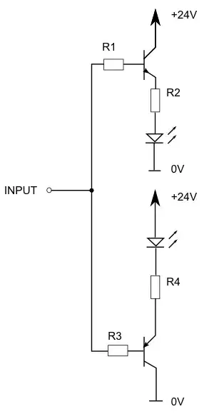

EDIT : So here is my schematic. It works fine for cases where the input is close to 0V or power supply. It however does not work when the input is unconnected, because current can flow through R1 and R3, and it will put transistors in linear mode and send some unwanted current through the LEDs.
I tried a similar circuit using common emmiter instead of common collector, but the fundamental problem is the same, when the input is left floating, the current can make it's way through the base of both transistors at the same time, putting them in linear mode, and having some current in the LEDs :

  • @EugeneSh. So that's probably while I'm failing at solving this problem, I'm mixing current and voltage point of view at the same time... right ? – Bregalad Sep 09 '16 at 18:23
  • @EugeneSh. I'm wishing to add the schematic of any of my failed solutions if that's necessary. – Bregalad Sep 09 '16 at 18:24
  • Sure. Add them. – Eugene Sh. Sep 09 '16 at 18:25

  • @EugeneSh. Done. – Bregalad Sep 09 '16 at 19:02

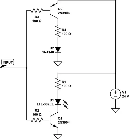

Figure 1. Current shunting the LEDs.
Rather than trying to switch the LEDs on under certain conditions it may be easier to switch the off by shunting the current around them. Can someone do a sanity check on this design?
How it works.
  • With SW1 high as shown, Q2 is biased off and Q1 is biased on shorting out D1. D2 will light.
  • With SW1 toggled, Q2 is biased on, shorting out D2, and Q1 biased off allowing D1 to light.
  • With SW in mid-position (disconnected) current will flow Q2e-b - R1 - R2 - Q1b-e, bias both transistors on and shunt both LEDs.
  • Current through R3 will be almost constant in the three states. With an LED on it will be \$ \frac {22}{470} = 47~\mathrm mA \$ rising slightly to \$ \frac {24}{470} = 51~\mathrm mA \$ when both LEDs are shunted.

  • Not the way that I'd do it but +1 for actually meeting the requirements of the original poster. – Dwayne Reid Sep 10 '16 at 13:30
  • @AndrewMorton: And the switch needs to have three positions, not two. An additional one for "unconnected." ;) – jonk Sep 10 '16 at 15:34
  • @AndrewMorton: Engineers usually can't spell. This one, apparently, can't count! Fixed, thanks. – Transistor Sep 10 '16 at 16:34
  • @jonk: "With SW in mid-position (disconnected) ..." was my attempt at making up for the limitations in the CircuitLab library. ;^) – Transistor Sep 10 '16 at 16:35
  • Thanks, @DwayneReid. What way would you do it? – Transistor Sep 10 '16 at 16:37
  • LOL, not a "nice" circuit, but it does meet the specs, so can't really argue. You really should point out, though, that R3 will dissipate 1 W. – Olin Lathrop Sep 10 '16 at 22:21
  • This does not cut off base current in the open position, only cuts it 50% , sorry nice try. – Tony Stewart EE75 Sep 10 '16 at 23:35
  • @TonyStewart: I stated that both transistors would be on in my third bullet point. That's the working principle of this circuit since the transistors shunt the LEDs and short them out. Are you still sorry? ;^) – Transistor Sep 11 '16 at 06:54
  • Oops.. ok you got my vote. But R3 1W fails the reality check problem with the question. – Tony Stewart EE75 Sep 11 '16 at 17:04
  • @Tony: Thanks. I agree that the big fat resistor doesn't look like a good idea but we probably don't have all the details of the application. We've seen worse around here! – Transistor Sep 11 '16 at 17:33

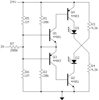

This is the same thing I showed yesterday, but with resistor values filled in and the input section changed a little to work around a problem pointed out by Dwayne Reid in a comment.
The requirements only specify what the circuit must do at three operating points, input tied to the supply, tied to ground, and left floating. This circuit is symmetric about the 1/2 supply point, so we only need to analyze the open case and when the input is tied to one of the rails.
When the input is left open, R5 and R6 form a voltage source attempting to drive the bases of Q1 and Q3 to half the supply. R1 and R2 likewise drive the emitters to half the supply. Both Q1 and Q3 therefore have 0 B-E voltage, which keeps them off. Since there is no base or emitter current, there is no load on the R5-R6 nor the R1-R2 voltage sources, so they are indeed half the supply. With no Q1 and Q3 collector currrents, Q4 and Q2 have no base current. This keeps them off, which keeps their collector currents at 0. These are also the LED currents, so the LEDs are off.
For the other operating case, we will pick IN tied to the positive supply (24 V). Let's say all the transistors have a minimum gain of 50, which is reasonable for small signal transistors. We'll also say the B-E drop of each transistor is 700 mV.
Since the bases and the emitters of Q1 and Q3 are tied together, one will be reverse biased while the other is forward biased. It should be obvious that with IN tied high, Q3 will be off, which also means Q2 will be off, which means D2 will be unlit. No current will flow thru any part of Q3, Q2, D2, or R3, so we can analyze this case as if these components were not present.
R1 and R2 form a Thevenin source of 1/2 the supply voltage with 10 kΩ impedance. With a minimum gain of 50, this will be reflected to the base of Q1 as 510 kΩ to infinite impedance. R5 and R6 form a Thevenin source of 1/2 the supply voltage with 500 kΩ impedance. Not considering the load from Q1 (Q1 gain infinite), the base voltage of Q1 is driven by a simple voltage divider, and is 20.6 V. With the gain of Q1 being 50, the extra load from the base brings it down to 18.9 V. The Q1 base will therefore be from 18.9 to 20.6 V depending on the actual gain of Q1. This means the emitter of Q1 will be from 18.2 to 19.9 V.
R1 and R2 form a 12 V source with 10 kΩ impedance. The emitter current of Q1 will therefore be in the range of 615 µA to 787 µA. The minimum collector current is 50/51 of that, or 603 µA. This is the minimum current the base of Q4 will be driven with. That means Q4 can support at least 30 mA collector current.
As a quick check, with the emitter of Q1 at most at 19.9 V, and the base of Q4 at 23.3 V, there is a minimum of 3.4 V across Q1 C-E, and it is well into its "linear" operating region. This shows the problem pointed out by Dwayne Reid in the previous design has been fixed.
Let's say D1 drops 2.1 V, and the minimum voltage across Q4 is 200 mV, that leaves a maximum of 21.7 V across R4. The maximum R4 current, which is also the maximum LED current is therefore 5.0 mA. Q4 can clearly support more current than that, and will be saturated regardless of where its gain or that of Q1 fall between 50 and infinity. With Q4 being able to support 30 mA but only needing to support 5 mA, there is a wide margin, indicating this design is has significant headroom with the minimum specified transistor gain of 50.
With IN at 24 V, LED D1 will light with 5 mA thru it, which is quite obviously lit for a modern green LED. It also runs the LED well below maximum, which is 20 mA for readily available indicator LEDs.
R4 will dissipate 110 mW, which is just within range of a 0805 properly mounted on a PC board. Any "1/4 W" resistor is more than adequate.
Again, the circuit will work symmetrically when IN is tied to ground. This time, Q3, Q2, and D2 will be on, with D1 off.
Therefore, D1 is lit when IN is at 24 V, neither LED is lit when IN is left floating, and D2 is lit when IN is at 0 V. Since these were the only requirements, this circuit meets the specifications.

  • The input needs to supply not only the entire base current for the output switches via the input BJT emitters, but also since the emitter must be at least $750mV$ or so above or below input (when connected), still more current into the Thevenin divider. Serious loading of input line, I imagine, if output BJTs are treated as switches (can't rely on their beta if not saturated, either) and supplying 40-50mA for the LEDs. – jonk Sep 09 '16 at 19:26
  • @Jonk: You are assuming incorrect relative resistor sizes. I'll probably get into this more tomorrow, but most of the Q1 and Q3 emitter currents come from R1 and R2, not the input signal. R5 is "high", and is only there to make sure Q1 and Q3 are off when the input is floating. With two transistors providing gain for each LED, the input impedance can be quite high. – Olin Lathrop Sep 09 '16 at 22:37
  • Okay. I was just giving it a first blush and thought things the other way. But I can switch my thinking around and imagine that the thevenin of $R_1$ and $R_2$ are supplying the principle currents. Thanks! You don't need to get into details. – jonk Sep 09 '16 at 22:43
  • I've given this +1 but I do think that 2 more resistors are needed: in the bases of Q1 & Q3. Examine what happens if the input is hard-connected to either +24V or Gnd - input current is high and there is a great possibility that neither LED will light. But the circuit topology is good. – Dwayne Reid Sep 10 '16 at 16:40
  • @Dwayne: Good catch. This has been fixed in the updated design I just posted. – Olin Lathrop Sep 10 '16 at 22:09
  • You're only going to get 5 mA through the LEDs with those 4k3 resistors in there. OP is looking for 25 to 50. Don't forget to point out that they will dissipate up to 1 W at 50 mA. ;^) – Transistor Sep 10 '16 at 22:34
  • @Trans: I missed the fact that he wants 25-50 mA thru the LEDs. Oh well. I guess this only shows how to reasonably light ordinary indicator LEDs. I could put 5 LEDs in series, adjust the LED resistors, and get the same amount of light as 25 mA thru a single LED. In a real world situation, I'd divide down the input signal and feed it into the inevitable microcontroller that is already there, then have that drive the LEDs as appropriate. – Olin Lathrop Sep 10 '16 at 22:45
  • I like this circuit the best. I'm not an analog guy but it appears you got the unconnected biasing correct. As far as the 1 Watt resistors that's not as bad as the challenge to power single LEDs with 24V @ 50mA. A more efficient LED would be make more sense to keep the power consumption down. – Misunderstood Sep 18 '16 at 02:40

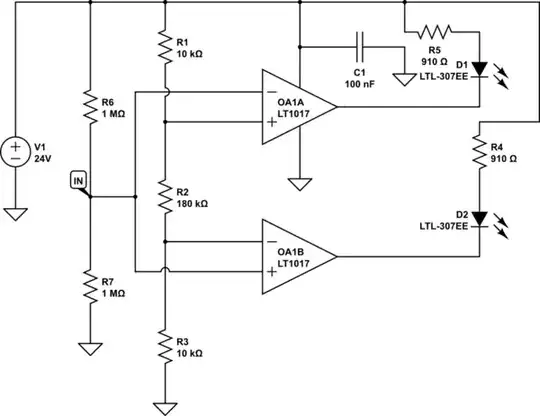

May as well add yet another random wag.
schematic
Per Transistor: ;)
Well, I figured that the opamp will have to source from its (+) rail when trying to pull its output up and will have to sink into its (-) rail when trying to pull its output down. I just made it so that in order to source from the (+) rail it has to pull that current through an LED and in order to sink into the (-) rail it has to sink that current through the other LED. I had to stick \$R_1\$ and \$R_2\$ at its output, too. The result is that the opamp will either (a) pull current through \$D_1\$ to sink into \$R_2\$, when hauling its output upward (lowering current in \$R_1\$ while increasing current in \$R_2\$), or else (b) sink current into \$D_2\$, sourced from \$R_1\$, when hauling its output downward (lowering current in \$R_2\$ while increasing current in \$R_1\$.) Well, there is case (c) where the PIN is left unconnected. Then the opamp will sink or source slightly different amounts through the diodes, but on the order of dozens of microamps in both cases so probably not visible.
jonk
  • 77,876
  • 77
  • 188
    I think this one gets the award for the screwiest, or cleverest abuse of a opamp. However, it is relying on unspecified behavior of the opamp. I've never seen a datasheet that promises what exactly the power and ground currents of a LM358 will be at different operating points. – Olin Lathrop Sep 10 '16 at 22:34
    Go on, Jonk. Add a little text. Nice idea. I'd forgotten this kind of trick. – Transistor Sep 10 '16 at 22:37
  • @OlinLathrop: I looked at the schematic for the LM358. I suppose they might redesign the thing. But I doubt it. – jonk Sep 10 '16 at 23:39
  • @Transistor: Done. – jonk Sep 10 '16 at 23:39

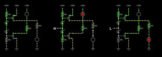

Lots of interesting options shown in the other answers, but I'll add another one to the mix:
Zener Diodes and MOSFETs
In this circuit the LEDs are driven by two MOSFETs - one LED is driven by a P-Channel and the other by an N-Channel.
The gates of the MOSFETs are pulled to opposite supply rails by 10k resistors which act to turn them off. The gates are then connected together with a pair of Zener diodes which are selected so that they have a forward voltage in the range:
$$V_{dd}/2 << V_{z} << V_{dd}/2 - V_{th}$$
Because the Zener diodes forward voltage is more than half the supply rail, and there are two in series, it means that when nothing is connected to the input (which is at the centre of the two diodes), the resistors will be able to pull the MOSFETs off as the Zener diodes are effectively open circuit.
When you pull the input (mid-point of the diodes) low, there is effectively now only one Zener diode between the PMOS gate and ground which allows the diode to conduct and so pulls the PMOS gate low which turns it on while keeping the NMOS off. Conversely, when the input is pulled high, there is now only one Zener diode between the NMOS gate and the supply rail which causes the NMOS to turn on which the PMOS stays off.
The Zener diodes will also regulate the gate voltages to the supply voltage minus the Zener forward voltage, so you don't need to find a MOSFET with a Vgs rating of the full supply (which is good as many are rated for 20V on the gate only).
For your 24V supply, I'd go for something like an 18V Zener diode as this will give you at least 6V Vgs so should allow the MOSFETs to turn on nicely.
You will need to size the two resistors to suit how much bias current can be drawn from the input. With 10k resistors as shown, around 0.6mA current flows to/from the input. If you go with say 100k you could bring this down to a few tens of microamps.
However, you can't make them too large as the Zener diodes will conduct a small amount of current even when below their threshold voltage. If the resistor are too large, then the MOSFETs may be turned on. It will depend on the I-V characteristics of the diode, but to be on the safe side 10k-100k should work perfectly well.
