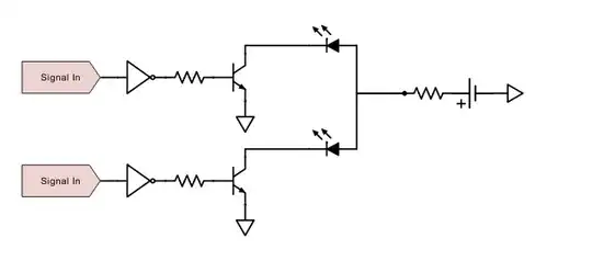

I'm working with a commercially available circuit that can optionally be configured to disable its internal LEDs and use two external LEDs. This post discusses the use of external LEDs. One LED or the other may be activated periodically; simultaneous activation of both LEDs never occurs. Both external LEDs connect to a common 5V source, and the cathode of each connects to one of the circuit's two LED output pins. When not activated, the output pins are left floating. When a pin is activated, it pulls its connected cathode to ground. The output pins each accept a maximum voltage of 5V, a maximum sink current of 20mA and cannot source current. I think the circuit, configured to use external LEDs, looks something like the following. (The mfr. documentation calls the output pins "open collector outputs", so I've shown them that way. But I think this is questionable, because their operation is described as though input signal is not inverted. It could also be that my understanding of open collector outputs is incomplete.)
Schematic showing how LEDs are connected to the circuit.

  • The short of it is this: You want to use a single bicolor LED (3-pin is commonly found) with two open-collector outputs of a COTS device where it is known in advance that one or the other or neither LED is to be lit, but never both. That about it? – jonk Sep 26 '18 at 21:58

  • @jsotola, the spec sheet says, "the LED Outputs (Pins 1 and 2) function as open-collector outputs. When the associated LED would be on, the output is tied to Load Negative (Pins 9-12). Otherwise, the output is left floating." My understanding of an open collector output is that when input signal is high, the NOT gate output is low, so there's no connection to ground. I believe they are saying that there's a connection to ground when input signal is high. I could be missing something, though. – dcorsello Sep 26 '18 at 22:19
    there is no mention of the input signal in that statement .... all it talks about is the output ...... they are saying that there is a connection to ground when the LED is on – jsotola Sep 27 '18 at 01:15

Given that the pins are open drain, the following circuit should work quite nicely:
schematic
You'll get some wasted power as one of the resistors will be pulled straight to ground when an LED is turned on, however if you go for a low-current LED, you can increase the resistance to reduce the amount of wasted current.
Alternatively, the simplest option would be to use a common-anode 3-pin bi-colour LED. This would then be wired up exactly as the diagram in your post, with the common anode via resistor to +5V, and the two cathodes to your outputs.
