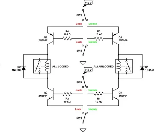

Reading between all the lines, I'm gathering you have four SPDT switches, which may either be in the LOCK or UNLOCK position. So the following circuit may be appropriate and relatively simple and very cheap. So how about using no ICs? Instead, just four BJTs and four resistors and two diodes.
I've chosen to use the Omron PCB G2RL Relay as a proxy for your \$12\:\text{V}\$ relay. It has a coil resistance of about \$360\:\Omega\$ and a coil inductance (based upon the datasheet switch timing I read) of \$1.8\:\text{H}\$. Most relays are designed to engage at 70% of their specified voltage, so the small \$V_\text{CE}\$ drops of the saturated BJTs should not be a problem. Of course, your relays can be something different. If enough different, the following circuit will need to be modified. But you'll have to pick a relay, first.

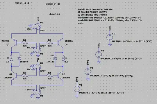

I had not tested the design through simulation before writing it out. But just to be sure it works, I did plug it into LTspice and used a 4-bit Gray code for activating the switch changes to provide coverage for all 16 permutations. (Using Gray coded switching helps avoid having to deal with "glitch" events during simulation.)
Here's the circuit I used for simulation (the two coils have a parasitic resistance equal to the relays mentioned above -- evidenced by the peak currents indicated.)

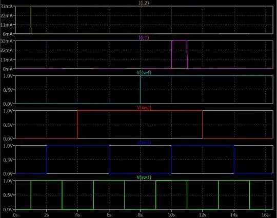

Here's the resulting information (including the state of each switch and relay):
A paltry bit of basic imagination, if I understood you well enough. I may have missed your meaning, though.

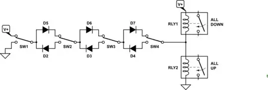

Figure 1. Two relays are used to provide ALL UP or ALL DOWN indication. With switches in the position shown the ALL UP relay will be energised.
The diodes prevent backfeeds.
There are a couple of points to watch:
  1. The diodes will cause about 2.1 V drop so your relays need to be able to energise on reduced voltage - 10 V or so.
  2. When not all switches are aligned the relays will have 6 V each across them. They therefore need to be able to drop out at 6 V otherwise the last one energised will remain on.

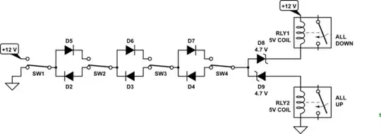

Figure 2. Modified circuit for 5 V relays. With switches in the positions show the ALL DOWN relay will be energised.
Adding the Zener diodes of Figure 2 and using popular 5 V relay coils should solve the hold-on problem.
  • With the switches aligned the energised relay receives 12 V - 3 x diode - 1 x Zener = 12 - 3 x 0.7 - 5.1 = 4.8 V or so.
  • With switches unaligned the relays will get \$ \frac {12 - 2 \times 5.1}{2} = 0.9 \ \text V \$ each which should be enough to guarantee drop out.

    I saw the first diagram a while back and immediately worried about your intent putting the two relays in series with each other. (And I didn't like it, at all.) The new one with the zeners also has a problem. Do you see it? (Aside from using 5 V when the OP wants 12 V.) Or, at least, I think it does. – jonk Apr 09 '19 at 22:31
  • Go on - what have I missed? I assumed the 12 V relay was negotiable. – Transistor Apr 10 '19 at 06:10
  • I think: 12V-4.7V-4.7V > Must release voltage – Huisman Apr 10 '19 at 06:22
  • @Transistor There's still substantial current in the relays when they are supposed to be inactive. (Not enough to engage them, I grant.) Perhaps 15 mA or so? – jonk Apr 10 '19 at 07:15
  • Not enough to engage them and, typically, not enough to hold them. I did cover that point in the last sentence. Thanks for the review, chaps. – Transistor Apr 10 '19 at 07:53
  • You did. I'm not disagreeing. I just still consider it to "be a problem" that was worse in the first schematic and better in the second, but not good enough that I liked it. I hope you don't mind that it bothers me, but I just don't like seeing all that waste taking place despite its cuteness. I'm also not above such odd things as you may remember from this. – jonk Apr 10 '19 at 17:31

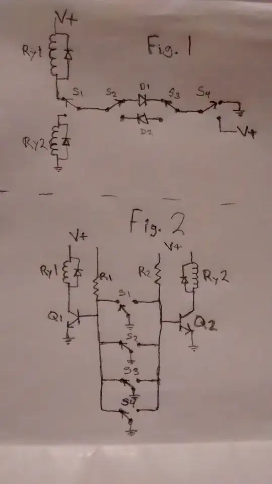

Now that I understand better what circuit function is desired, I have created two new ones. Figure 1shows a series connection; when all switches are in the up position relay one is on. When they are all in the down position relay two is on. The switch connection and D1 and D2 prevent either relay from acting with any other switch combination. Figure 2 shows a parallel connection; with all switches to the right relay 1 is on; with all to the left relay 2 is on.enter image description here
EinarA
  • 897
  • I think yours is potentially better than mine because I think the OP wants the one relay to be energised when all switches are in the same orientation. You can accomplish this by omitting RY2 and connect the two collectors together. – Transistor Apr 12 '19 at 14:08
  • That is the function of the circuit I described in my first answer which he seemed to disagree with. – EinarA Apr 13 '19 at 18:33
