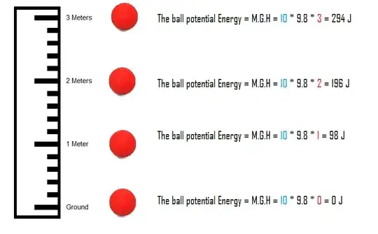

Imagine we have a ball of mass M = 10 kg.
This ball exists in a conservative gravitational field (the Earth's gravitational field). If we want to raise it by a height of 1 meter, we must - somehow - supply an X amount of energy, that gives the ball enough speed to move 1m above the Earth's surface.
We will give the ball this amount of energy in terms of kinetic energy (speed). So we throw the ball upwards with some speed, and as the ball moves upward, its speed decreases; and its potential energy increases until it stops and all the kinetic energy is converted to potential energy.
The following picture shows the amount of potential energy for a ball of mass M = 10 kg at different heights above sea level:
energy at different height levels

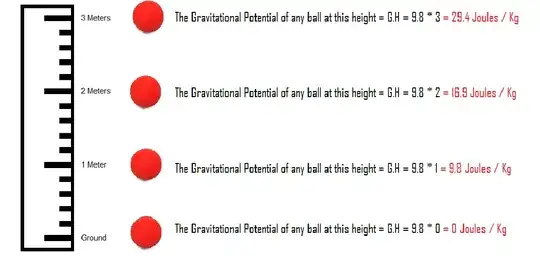

But what if we want to make a generic scale?
For any ball of an arbitrary mass, at any height, we can get the amount of energy for every 1 kg in it (Energy per mass):
energy per mass at different height levels
Now we can say that, at a height of 3 meters above sea level, any object of mass X will have an amount of energy equals 29.4 joules for every 1 kg of mass. This is due to the earth's gravitational field.
Voltage, or electric potential, is the amount of potential energy (joules) that any "charged body" within an electric field will have, for every 1 coulomb of electric charge in it.

  • One might add that the potential energy does directly translate into kinetic energy if there is only negligible "friction", for example in an (evacuated) cathode ray tube. The kinetic energy of an electron is indeed measured in "electron volts", eV, the energy an electron gains or loses when moving through a potential difference of 1 Volt. – Peter - Reinstate Monica Jul 14 '16 at 11:24
  • It's not that isolated right? Since With V = I/R a V increase also forces a I increase. So the number of coulombs also increase by the same amount. – Cojones Dec 02 '18 at 06:40
    Voltage is not the speed at which electrons move, but at the atomic level, what is it that makes a higher voltage deliver the same power as a lower voltage with higher current? Something must be happening to the electrons. 1 C of charge in a 100V circuit will 10x more power of 1 C of charge in a 10V circuit but what does that even mean? Does it mean that the electrons have more energy to push whatever comes in front of them? – MeTitus Apr 19 '20 at 18:59
  • @MeTitus Yes. Energy is charge times voltage. One electron accelerated through 100 V will gain 100 eV of energy. Or 10 electrons accelerated through 10 V will in total gain 100 eV of energy. In a resistor all of this energy the electrons gain will be lost to the resistor in the form of heat. – Matt Feb 04 '21 at 02:19
    But the ball's speed increases if it is dropped from 3 meters, so does voltage affect the speed of electrons? – Qwerty Feb 27 '21 at 18:11
