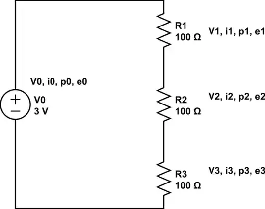

We need only two simple assumptions for current and voltage within a loop.
Neither current or voltage is lost or increased within a loop.
schematic
So the summ of all voltages within the loop is zero. V0 + V1 + V2 + V3 = 0
The currents through all resistors and the voltage source are equal. i0 = i1 = i2 = i3
All connections with wires are perfect, the voltage drop is zero. All insulations are perfect, no current flows between unconnected terminals. The behavior of equal resistors is the same.
The only possible solution is: i0 = i1 = i2 = i3 = 10 mA V1 = V2 = V3 = - 1 V
Now to the energy conservation. If we multiply voltage with current to get the power:
V0 + V1 + V2 + V3 = 0 and i0 = i1 = i2 = i3
V0 * i0 + V1 * i0 + V2 * i0 + V3 * i0 = 0
P0 + P1 + P2 + P3 = 0
So all power from the voltage source is consumed by the resistors.
Energy is the product of power and time:
P0 * t + P1 * t + P2 * t + P3 * t = 0
e0 + e1 + e2 + e3 = 0
So no energy is added or lost, energy conservation it true.
