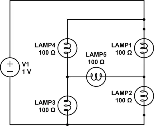

Just today I was suddenly curious to know how a closed circuit works. I have learned some basics so far. I understand how it is supposed to work and mostly why. But some things elude me, and my searches to understand the behavior of current always leads back to the conventional vs electron flow debates.
Would appreciate help in wrapping my head around some concepts. I likely won't pursue anything further, I really just want to understand how the current moves.
schematic
I have no idea if this circuit actually works, but ignoring the units and sticking to the layout it's the best way I can ask by example. So I guess using conventional flow, if the current reaches that first fork, what happens?
Does the current travel to both LAMP1 and LAMP4 regardless of resistance? Does the amperage of the current now split in half or does it remain equal or proportional based on resistance for both paths?
Assuming the current did travel to LAMP4, would it from there still try and travel to LAMP5 or would it only continue to LAMP3 because the negative end of the battery is not in that direction?
And what about LAMP5 anyway.. would it be receiving current from both sides?
Would the current amperage leaving LAMP3 possibly be different than that leaving LAMP2? If so, what happens when they meet where the wires intersect?
Would really appreciate the insight.

    May I recommend that you shorten your question to remove the capacitor. Then you circuit is easier to explain. Ask about capacitors in a separate question is my advice. – Andy aka Jul 26 '16 at 11:49
  • Your lamps are connected in a bridge circuit that is not, generally, solvable by Ohm's Law. With the resistance values chosen, you've hit on a special case where the bridge is balanced, so in this case the current does divide equally at the top junction. Best to start with a simpler series/parallel configuration and, as Andy recommends, omit the capacitor for the time being. – Chu Jul 26 '16 at 12:48

Let's have a look, first we ignore the capacitor for your current question.
The resistors (lamps) all have the same value. We assume that we have ideal, or at least identical wires (let's just say the wires have 0 ohm). The current splits exactly 50/50 because we have the same resistance in every path. Because we have the same resitance everywhere, we have the same potential on every lamp (except lamp5).
Now to lamp5. In theory there is no current running in this path. That's because we have the same potential on the left and right node and when there is no difference in the potential there is no voltage drop (Just imagine two forces with the same power pressing against each other - no one moves). When there is no voltage drop there is no current (U = R*I, U = 0 so I is 0 too).

  • So if I understand, ignoring the capacitor, if the current was 100 it would split at the fork and 50 would go to LAMP4 + LAMP3 and 50 to LAMP1 + LAMP2. LAMP5 is cancelled out. Will the current become 100 again when the two 50's meet up again? (pretending that the lamps didn't decrease anything.. if they even would) – Chibi Jul 26 '16 at 20:15
  • Current doesn't 'decrease' as it flows around a circuit. Whatever flows in to a component, flows out at the other end. Also, the sum of the currents towards any junction is equal to the sum of the currents away from that junction. – Chu Jul 26 '16 at 20:59

In an ideal circuit, LAMP5 will see zero voltage (and, consequently, zero current) forever. Note that real-life parts are not ideal. Moreover, most light sources either have their resistance dependent on their internal temperature (hence, power) or defy the Ohm’s law outright. For incandescent lamps, for example, the resistance/temperature dependence results in a strong positive feedback in serial circuits. Gas discharge lamps are even worse due to their unpredictability. Conclusion: in the real life one can’t be sure that LAMP5 will always be dark.

Someone with experience may look at this circuit and assume the power is off at first. (Otherwise the answer is simple, all lamps are off.) Then when the power is applied current will flow through all the bulbs except 5. This is because you place 5 at a balancing point of sorts. In order for current to flow through a load the voltage has to be different at each end. But your design is symmetrical so there is not a voltage difference. Going on, as time passes the capacitor will charge up and the current will stop. All the lights will go out.
